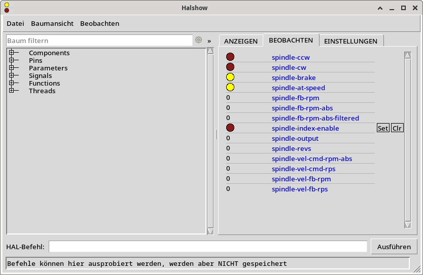

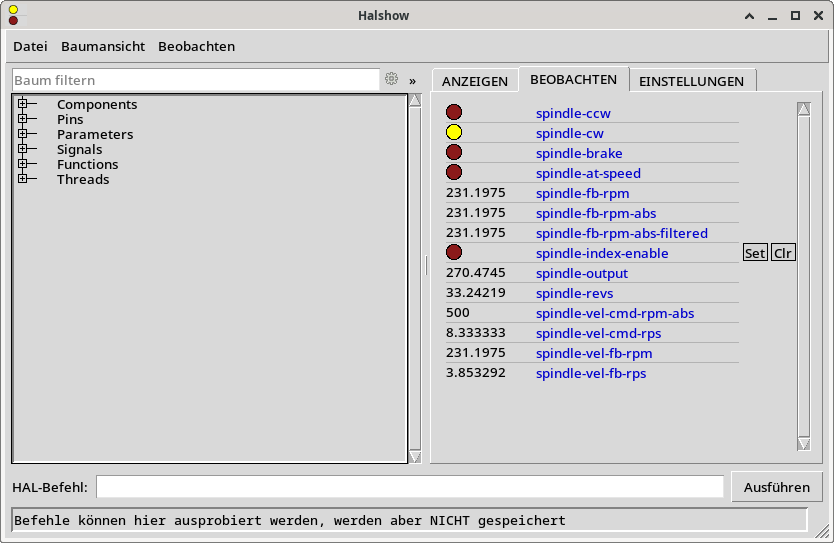

03 Aug 2024 18:11 #306871
by Basti
Replied by Basti on topic CCW dosen´t Work
Hello everyone, with spumco's idea the ccw works. Only that the spindle accelerates to the maximum and ignores every S command.
As for the hardware, there is an old Contraves ADB/F converter installed for the spindle that needs +/- 10 volts. This is cams from The Mesa 7i83
I also noticed that my spindle at speed is only displayed when it is stationary.
However, the expected value for CCW now shows that the S500 only revs up to full speed.
Attached are pictures of standstill and M3 S500. M4 I don't dare take a screen shot because the spindle rotates at 6000 when cold
Thank you very much for such quick answers

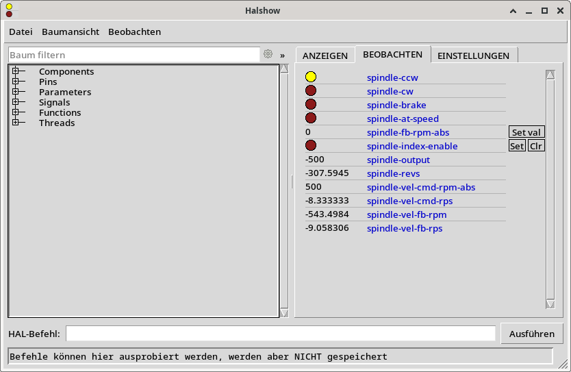

03 Aug 2024 20:09 #306877
by Basti
Mega M4 does almost what it's supposed to do,
still can't get the spindle at speed but the speed is just a little bit higher.
the problem was in the Hal, I deleted it.
I also changed the tuning as you suggested
This did the strange run up for CCW
# Use ACTUAL spindle speed from spindle encoder
# Spindle speed jumps back and forth, so we filter it with low pass
# Spindle speed is signed, so we use an absolute component to remove the sign
# ACTUAL speed is in RPS, not RPM, so we scale it.
setp scale.spindle.gain 60
setp lowpass.spindle.gain 1.000000
net spindle-vel-fb-rps => scale.spindle.in
net spindle-fb-rpm scale.spindle.out => abs.spindle.in
net spindle-fb-rpm-abs abs.spindle.out => lowpass.spindle.in
net spindle-fb-rpm-abs-filtered lowpass.spindle.out
