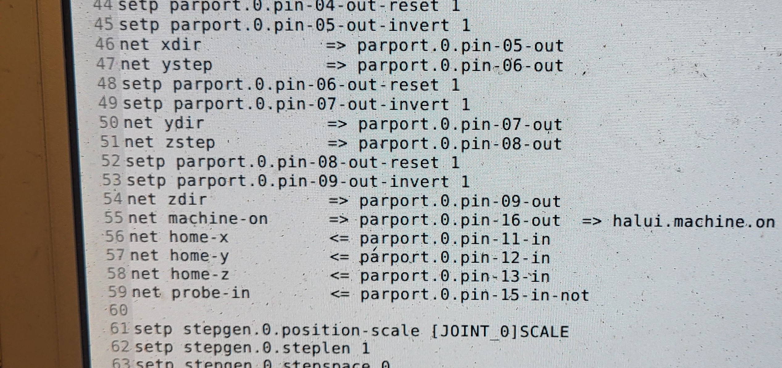

04 Oct 2024 16:24 #311296 by Dougal9887
Replied by Dougal9887 on topic Machine On button.
Gmoccapy started now without error, but the button does not change the state of pin 16 unfortunately.  I've attached pic of line 55 added.
Any more ideas?
Thanks, Dougal.
04 Oct 2024 16:54 - 04 Oct 2024 16:56 #311298 by Aciera
Replied by Aciera on topic Machine On button.
I misunderstood what you wanted. If you want to output a signal when the machine is on then change this:
net machine-on => parport.0.pin-16-out => halui.machine.on
to:
net machine-on => parport.0.pin-16-out <= halui.machine.is-on
Last edit: 04 Oct 2024 16:56 by Aciera.

08 Oct 2024 06:55 #311542 by Dougal9887
Despite the fact that, following the above, switching on the machine from gmoccapy now, and happily, does exactly that, I am trying to understand a little of how and why.
I think I can now see that the first response, 'machine.on', appears to be correct.
However, when that didn't work and I attached the snippet of code, the respondent was alerted to the code being that code run before the gui started and changed the response to 'machine.is-on'.
I put the line of code in the configuration  .hal file simply because it was the only file I have ever altered.
It now appears to me that, since the action I wanted occurs after the gui is open, the code should have appeared in a postgui hal file.
So my question now please is, to achieve the action stated above, what should the line of code look like to attach the gmoccapy 'machine on' button to parallel port pin 16 and switch on the machine, where should the line of code be written and where would I find that place?
It would also be interesting to understand why 'machine.is-on' works to toggle the button on/off when it is described as an input, presumably to display the current state of the machine.
Thanks, Dougal.
08 Oct 2024 07:25 #311544 by Aciera
'halui.machine.on' is an input that is used to put the machine in the 'on' state. I suggested using this because I falsely thought you wanted to use an external switch to do that.
Since we are not using any gmoccapy related pins there is no need to put this in the postgui_halfile. 'halui' pins exist already before the gui has loaded. The button state in the gui reflects the state of 'machine.is-on'.
'halui.machine.is-on' is an _output_ that reflects the current state of the machine.
linuxcnc.org/docs/html/gui/halui.html#_machine
