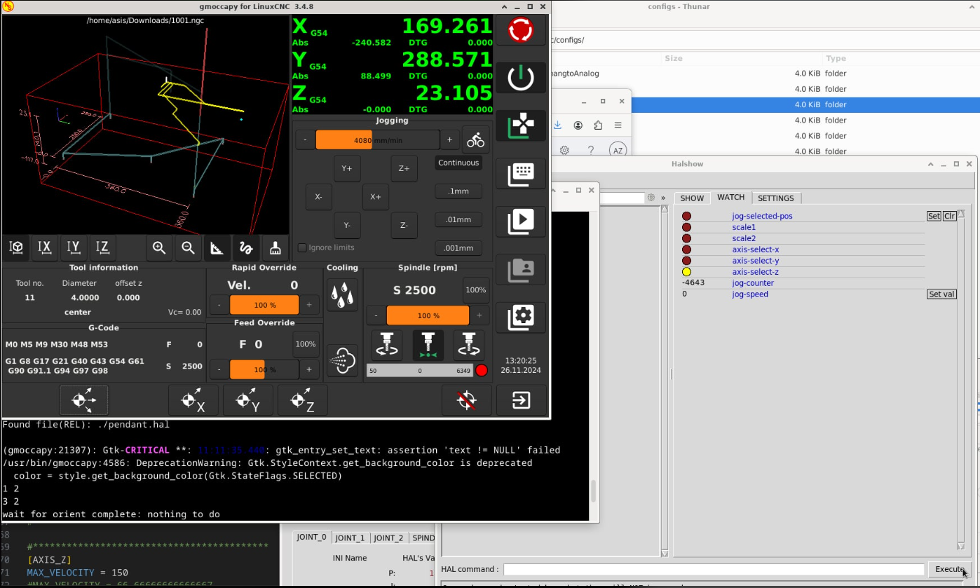

Before yesterday I can use Pendant for jog XYZ and x1 x10 x100 step excellent to work (7i73 MESA)
I have a problem yesterday I use GMOCCAPY start up good and "before" home machine I can use pendant for jog .
After Home XYZ done screen DRO will change green color and then I can't use pendant, If want for pendant I will click Icon UNHOME it's will back to use pendanr again , WHY ?
I'm not sure this problem come from I use sudo apt update and upgrade yesterday .
I try check After HOMED , Open halshow and try use pendant handwheel roller Encoder can show number change with wheel rotation.
I try use knob select X Y Z axis its show select active LED yellow and correct.
Have any Idea for me check ?

Your Jog Speed shows Cero
May be that is the problem?
Norbert
Norbert
