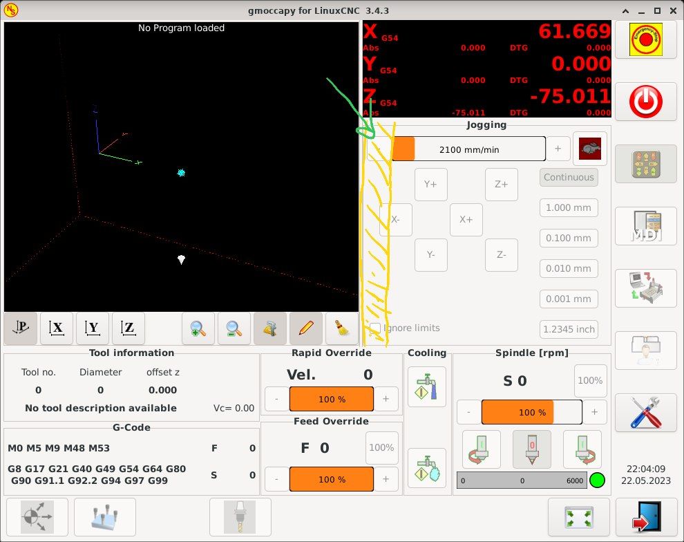

When I use the mouse, the speed reduction button works fine
But when I use the touchpad, it doesn't work
I noticed that the touchpad doesn't work in the area I marked
I think if I make it bigger, it will solve my problem
Can anyone tell me how to fix this?

Replied by newbynobi on topic The jog speed reduction button on the touchscreen does not work.
IMHO that bug has been fixed with a recent patch.
So using gmoccapy 3.4.9 should solve that.
Norbert
Norbert

Replied by Ehsan_R on topic The jog speed reduction button on the touchscreen does not work.
Can you explain how I can do this?
Many thanks
Many thanks

Replied by zz912 on topic The jog speed reduction button on the touchscreen does not work.
You should update whole LCNC to 2.9.4
