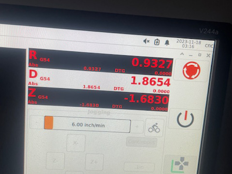

Lathe axis display

Replied by tommylight on topic Lathe axis display
Nothing to fix there, that is all correct for a lathe, you have the X R-adius and X D-iameter, where radius is what you are taking off and diameter is the total size of the part.

Replied by newbynobi on topic Lathe axis display
Depending of the mode: Radius Mode or Diamiter Mode one off the DRO (R or D) is grey, meaning not active.
That way you see very quick with mode you did activate with your gcode.
