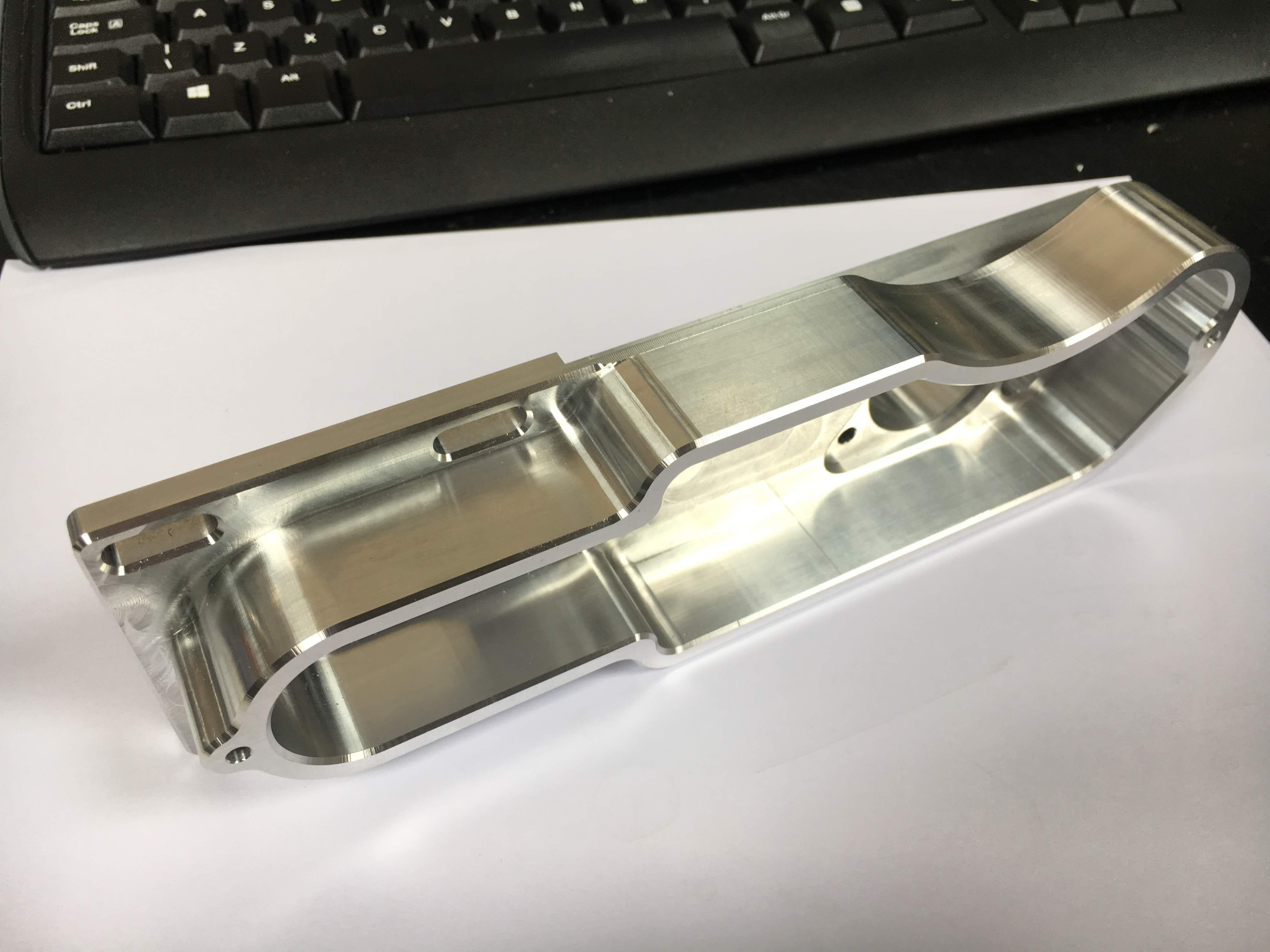

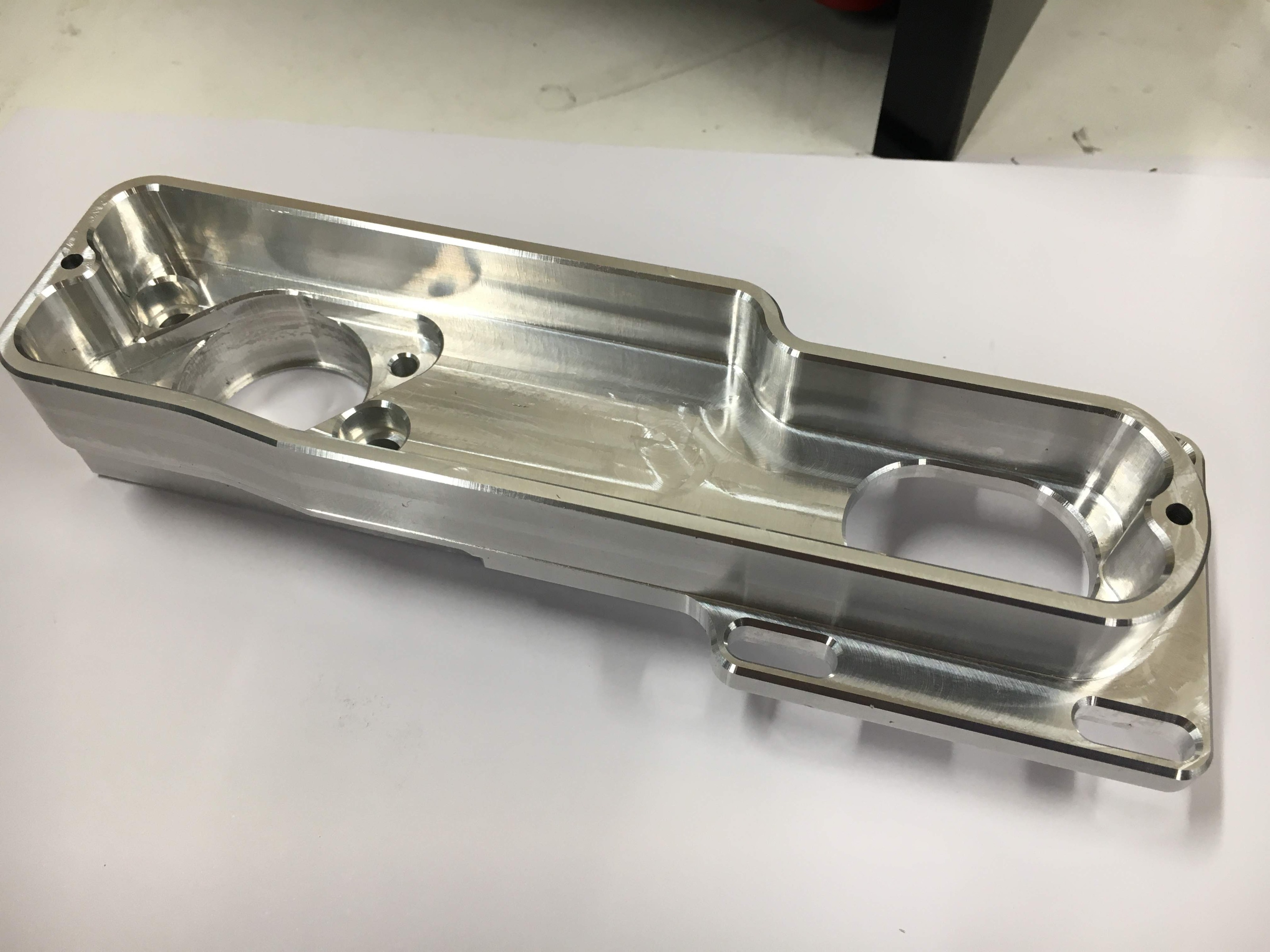

16 Dec 2025 10:17 #340181
by Muzzer
Replied by Muzzer on topic Updating from LINUXCNC - 2.8.4-23, Mint 20.3 - gmoccapy lathe structure
Haha no problem! Yes, I know I still have a lot to learn but I think I'm getting there in my own time.
I won't bother with pics of floors, roofs or pipes but here's some metal I did earlier in 2019. I look forward to hearing where I'm going wrong!
Like a lot of people on here, I also have a day job - in my case power electronics product development that requires a fair bit of travel to Korea and Japan, in addition to time in the office each week away from home.
The following user(s) said Thank You: tommylight, , unknown
- unknown
- Posts: 888
- Thank you received: 325
16 Dec 2025 11:43 #340187
by unknown
Replied by unknown on topic Updating from LINUXCNC - 2.8.4-23, Mint 20.3 - gmoccapy lathe structure
Pretty sweet.
Nah that's really sweet. Wot it do ?
- Posts: 21625
- Thank you received: 7383
16 Dec 2025 17:41 #340205
Replied by tommylight on topic Updating from LINUXCNC - 2.8.4-23, Mint 20.3 - gmoccapy lathe structure
Mmmmm shinny ...
I would venture a guess at it being a motor and ballscrew holder/mount with belt going inside of it ?
