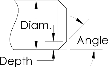

This subroutine is for tapering the OD of a part in my lathe.
If you place the attached png image in the same directory as the subroutine it will show up in ngcgui.

#<diameter>    = #1  (= 0.750 Stock Dia)
#<final-depth> = #2  (= 0.120 Taper Depth)
#<doc>         = #3  (= 0.025 Depth of Cut)
#<angle>       = #4  (= 45 Angle of Taper)
#<z-start>     = #5  (= 0.000 Z Start)
#<feed>        = #6  (= 2 Feed Rate)
#<tool>        = #7  (= 1 Tool Number)
#<max-rpm>     = #8  (= 2000 Max RPM)
#<sfm>         = #9  (= 100 SFM)
#<coolant>     = #10 (= 8 Flood=8, Off=9)
