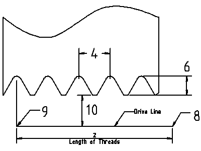

This is my G76 threading subroutine. Place the attached image in the same directory.
(info: G76 Threading)
o<g76> sub
#<tool>         = #1 (= 7 Tool)
#<rpm>          = #2 (= 250 RPM)
#<diameter>     = #3 (Diameter)
#<tpi>          = #4 (TPI)
#<inital_depth> = #5 (= 0.010 Inital Depth)
#<thread_depth> = #6 (= 0.045 Thread Depth)
#<spring_pass>  = #7 (Spring Passes)
#<z_start>      = #8 (= 0.100 Z Start)
#<z_end>        = #9 (Z End)
#<x_offset>     = #10 (= 0.025 X Offset)
#<q_angle>      = #11 (= 29.5 Combine Angle)
#<taper>        = #12 (= 0 Taper 0=none 2=exit)
#<coolant>      = #13 (= 8 Coolant 8 On 9 Off)
#<pitch> = [1/#<tpi>]
#<radius> = [#<diameter> / 2]
G8 G18 G20 G40 G49 G97
T#<tool> M6 G43
M#<coolant>
S#<rpm> M3
G0 Z#<z_start> X[#<radius> + #<x_offset>]
G76 P#<pitch> Z#<z_end> I-#<x_offset> J#<inital_depth> K#<thread_depth> Q#<q_angle> L#<taper> E#<thread_depth> H#<spring_pass>
M5 M9
G53 G0 X0 Z0
o<g76> endsub

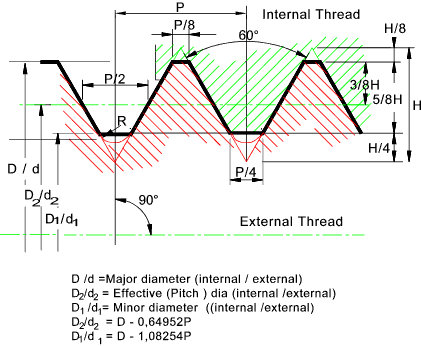

   o110 if [#<_PeakOffset> GT 0]
      (internal = pitch * cos30 * 2 * 6/8 - 2 * tip radius)
	  #<_ThreadDepth>=[#<_Pitch> * 1.299 - 2 * #<_TipRadius>]
	  (thread height = pitch * cos30 * 2 * 5/8)
	  #<_MinorDiameter>=[#<_MajorDiameter> - #<_Pitch> * 1.0825]
	  #<_Diameter>=[#<_MinorDiameter> - #<_PeakOffset>]
   o110 else
      (external = pitch * cos30 * 2 * 7/8 - 2 * tip radius)
	  #<_ThreadDepth>=[#<_Pitch> * 1.5155 - 2 * #<_TipRadius>]
	  #<_Diameter>=[#<_MajorDiameter> + #<_PeakOffset>]
   o110 endif
