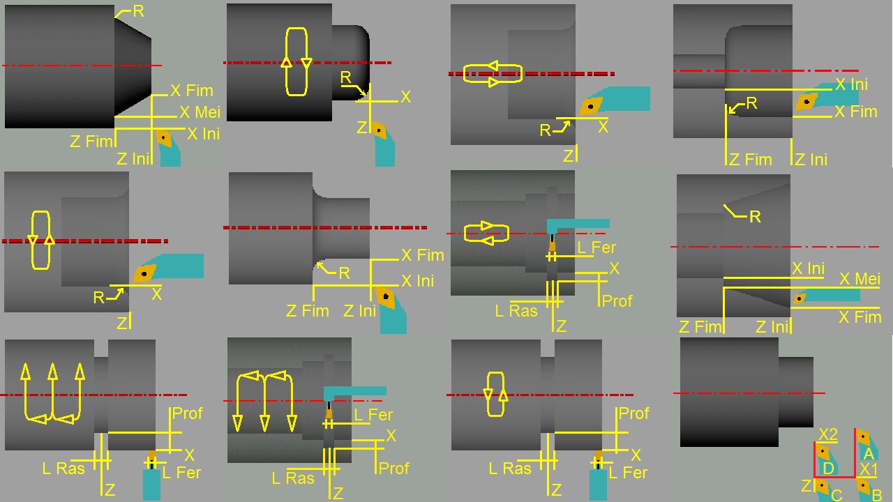

Hi!
These are probably all my lathe NGCGUI routines. I have been making them for several years now. Everytime I need a new one I find some time to code it down.
I tried to keep them as close as Mach3 Wizards as I could. I even edited the images to look similar.
They were running just fine in my latest retrofit.
I hope it helps someone.
