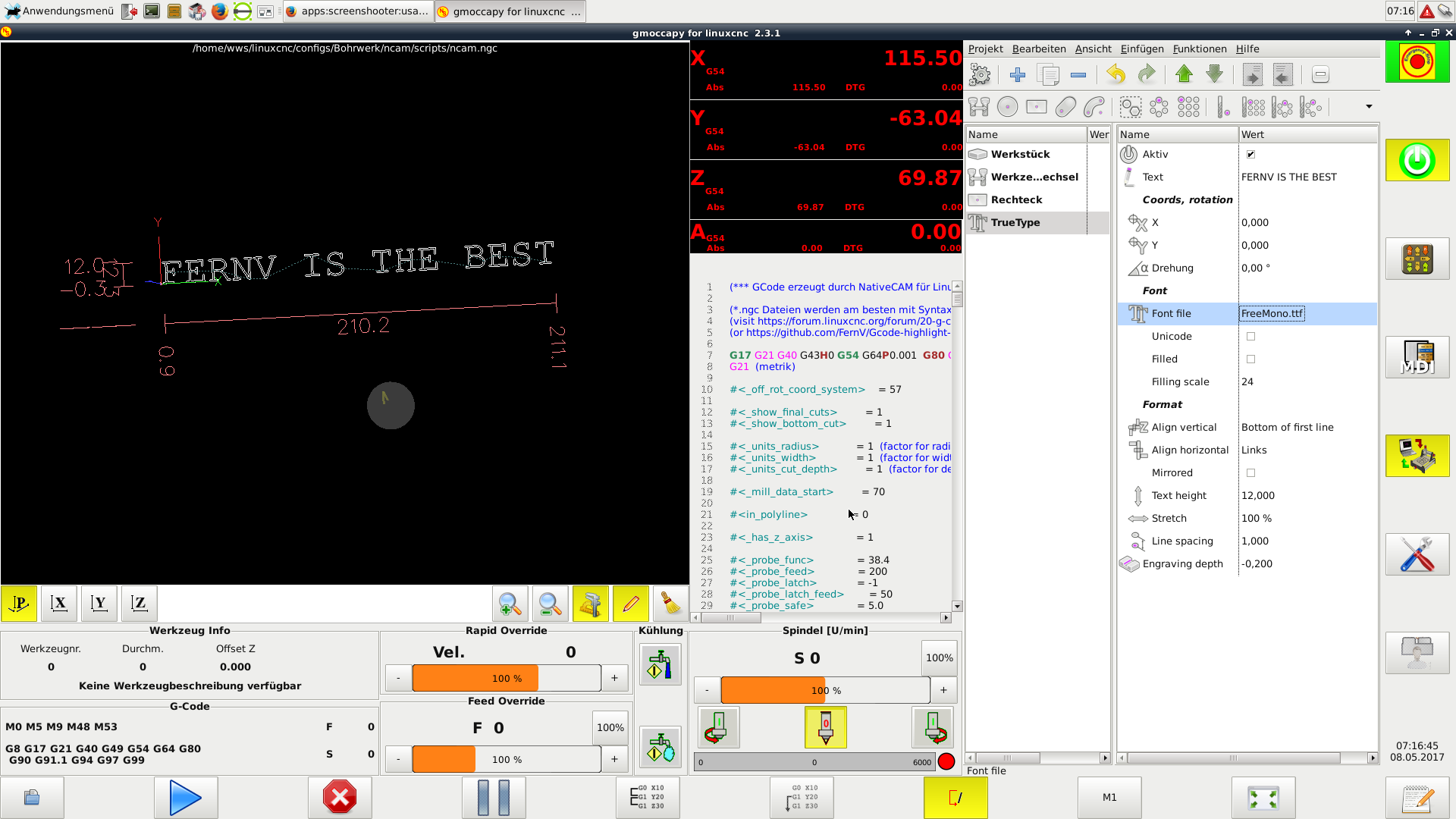

- FernV
- Posts: 457
- Thank you received: 124
07 May 2017 13:20 #92776
by FernV
Replied by FernV on topic Update NativCAM
Hi Florian,
I was not aware of your problem until 2 days ago...
I just pushed some fixes and hope it will solve the problem
Regards
Fern
P.S I will push files for TT font engraving later today
Regards
Fern
- absolut15
- Posts: 28
08 May 2017 05:18 #92805
by absolut15
Replied by absolut15 on topic Update NativCAM
HI Fern!
it is monday and 7 am in the mornig ..normaly not a good time but you made it a lot better this time.
i make a new deb file and i install it . and alll works perfekt .
thanks a lot
florian
