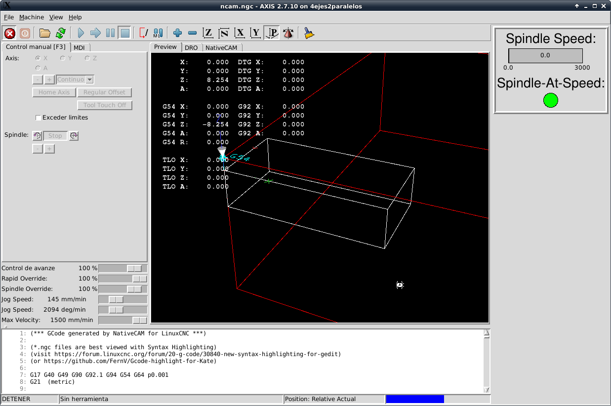

- jmmontes
- Posts: 5
19 Jul 2017 18:57 #96096
by jmmontes
Replied by jmmontes on topic 31659-nativecam-is-features examples
Hi Fern,
Example does not open, screen stays as in attached screenshoot, I have to force closing lcnc.
José Miguel

19 Jul 2017 20:23 #96099
by FernV
Replied by FernV on topic 31659-nativecam-is-features examples
José,
Fern
- Restart lcnc.
- Uncheck Auto-refresh from NativeCAM Utilities menu
- Open 'basic spacer.xml' example
- Change values in Params for some metric ones
- Click on the Build Button (the one that looks like a gear)
Fern

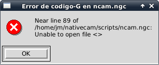

20 Jul 2017 17:34 #96155
by jmmontes
Hi again Fern,
Thanks again for your proactivity.
I attach g-code error.
Before asking for your support, I uninstalled ncam, deleted ncam directory in /home/jm and all ncam folders inside /home/jm/linuxcnc/configs, then Installed ncam 1.6 by means of apt-get install.
Take also into account that now my version is linuxcnc 2,7.10 due to last update.
José Miguel
José Miguel

20 Jul 2017 18:28 #96160
by FernV
Hi José
You are not giving me much stuff to help you solve your issue. I think it is something you have not configured well but I need to see more.
I see you are using nativecan stand alone.
I want to see ncam.ngc, the output of the terminal when you run it, the directory and sub-directories content where your inifile is.
I guess you have executed $ ncam -i inifile -c mill -t
because I saw that ncam is in a tab.
Give me everything, so I can help
Fern
