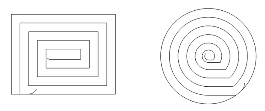

I am workng on a spiral mode for pockets and the path I think about is this :
Any comments ?
Fern

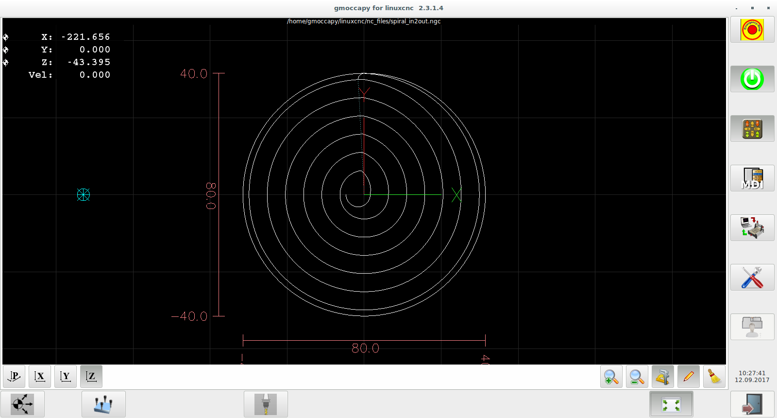

12 Sep 2017 08:34 #98865 by newbynobi
Replied by newbynobi on topic Spiral path for pockets with NativeCAM
Hallo Fern,
The new spiral tool paths are not so heavy for the milling tools, as the load is more constant. Please find attached my parametric spiral ngc code in the most recent version. The realized path is shown on the screenshot, and that looks more uniform than yours.

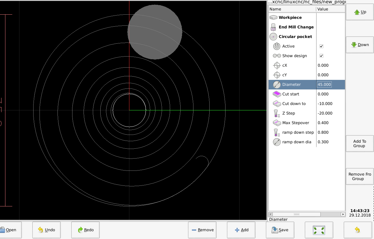

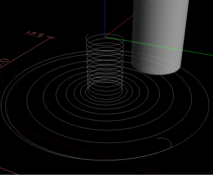

29 Dec 2018 13:15 #123071 by fixer
Replied by fixer on topic Spiral path for pockets with NativeCAM
proof of concept of what I had in mind in attachment. Circular pocket is a simple example, and it could be easily done in gcode alone, but the same principle can be used for generating more complex paths. For example, slot clearing of long and narrow rectangles,...

31 Dec 2018 20:32 #123237 by FernV
Replied by FernV on topic Spiral path for pockets with NativeCAM
This is exactly what will be in the next release
