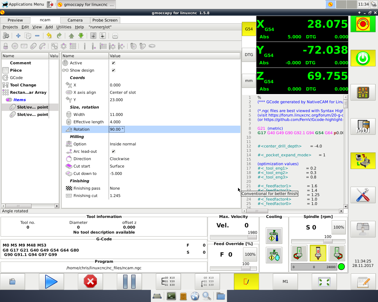

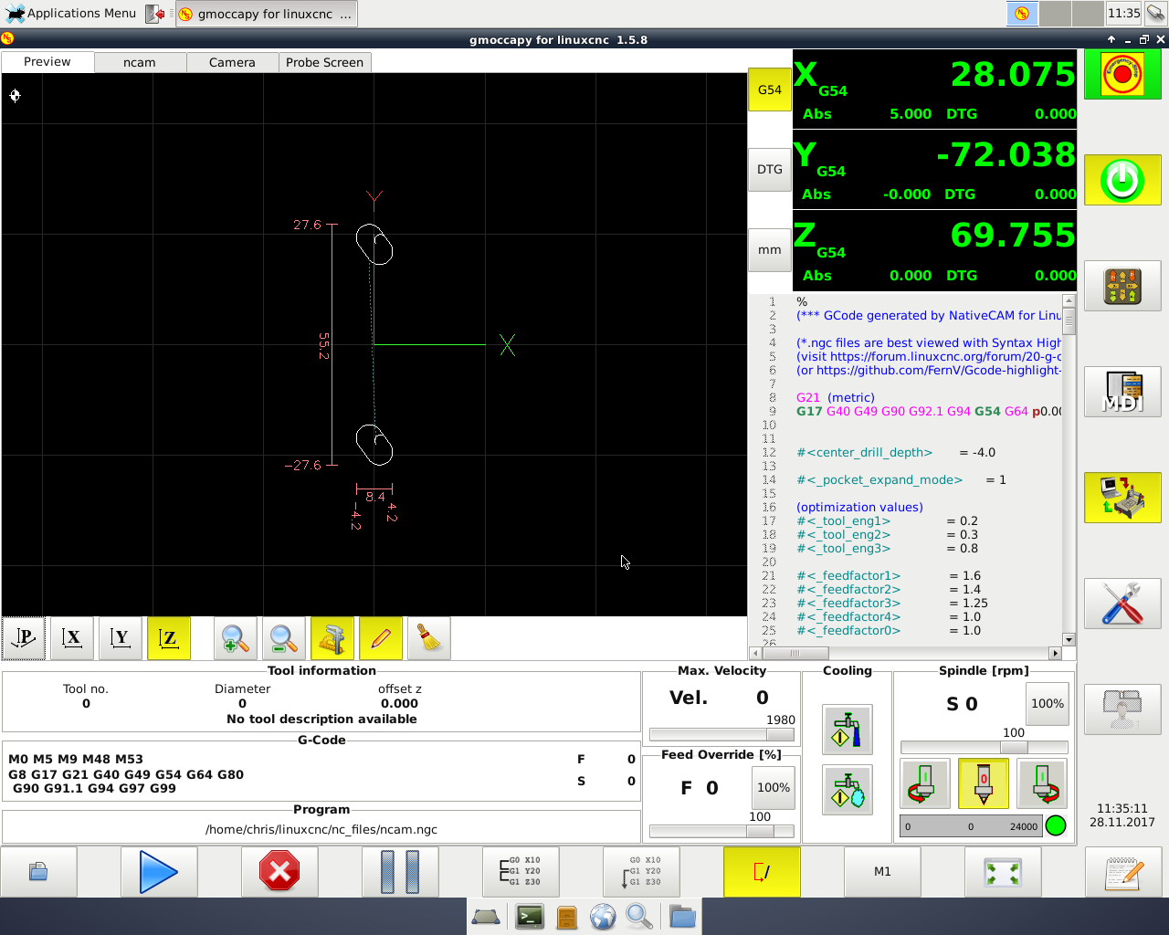

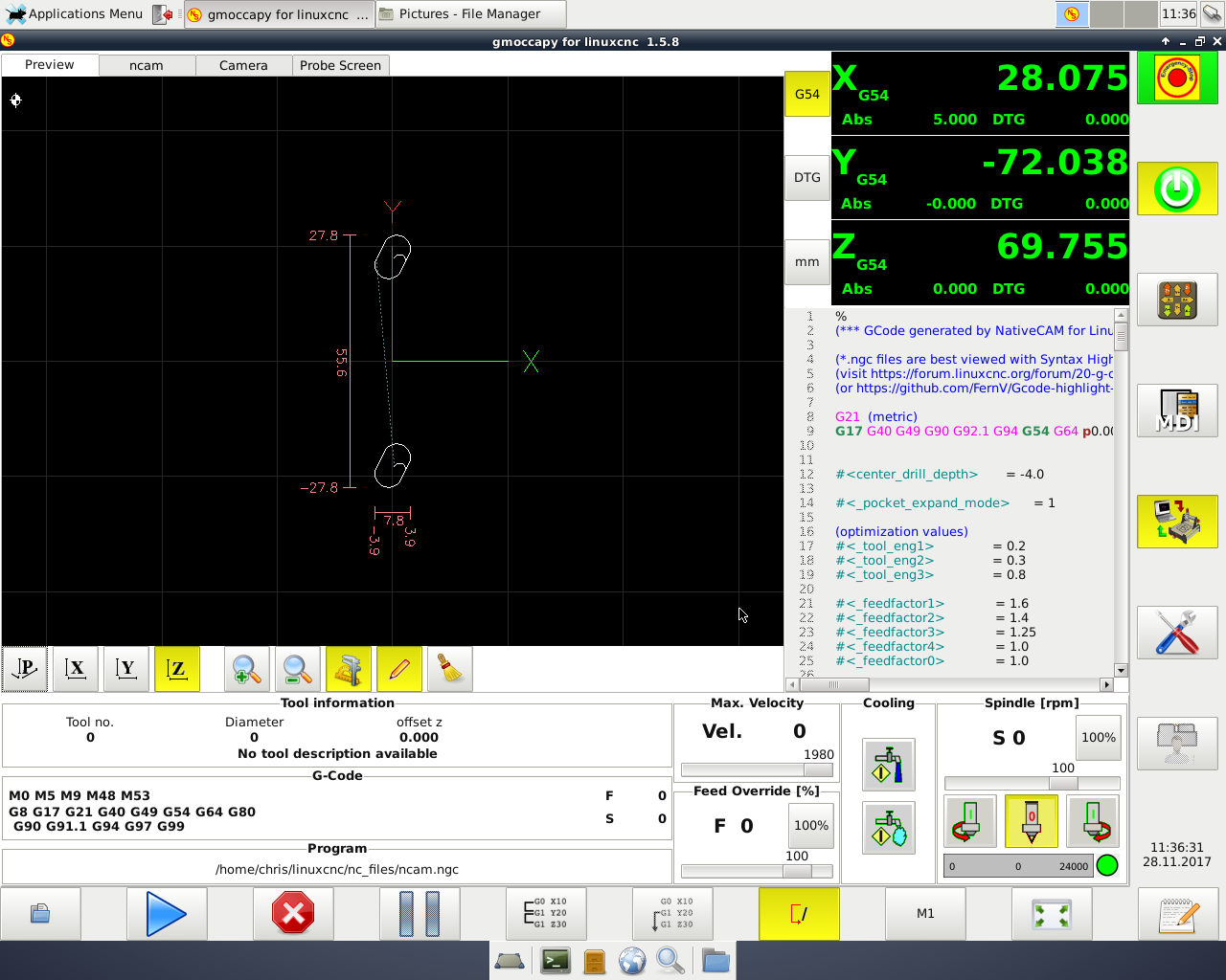

Hi Fern, I have updated to version 0.1.14 this morning. I am having trouble with the rotation of a slot/oval from one point.
At 0 degrees, all is ok, but at an angle the rotation is incorrect. See the attached pictures.
Keep up the good work.

For a reason I do not know yet, the angle is multiplied by 25.4 on all metric setup.
For a quick fix this morning, enter 90/25.4 for the rotation
Fern
P.S. Slot with 2 points is OK
Fern

Yes that corrects the problem. Serves me right for working in mm.
Many thanks
Many thanks

Problem solved, enter rotation angle without dividing with 0.1.14a update
Fern
Fern

tested 0.1.14a, all ok. many thanks for your quick response
