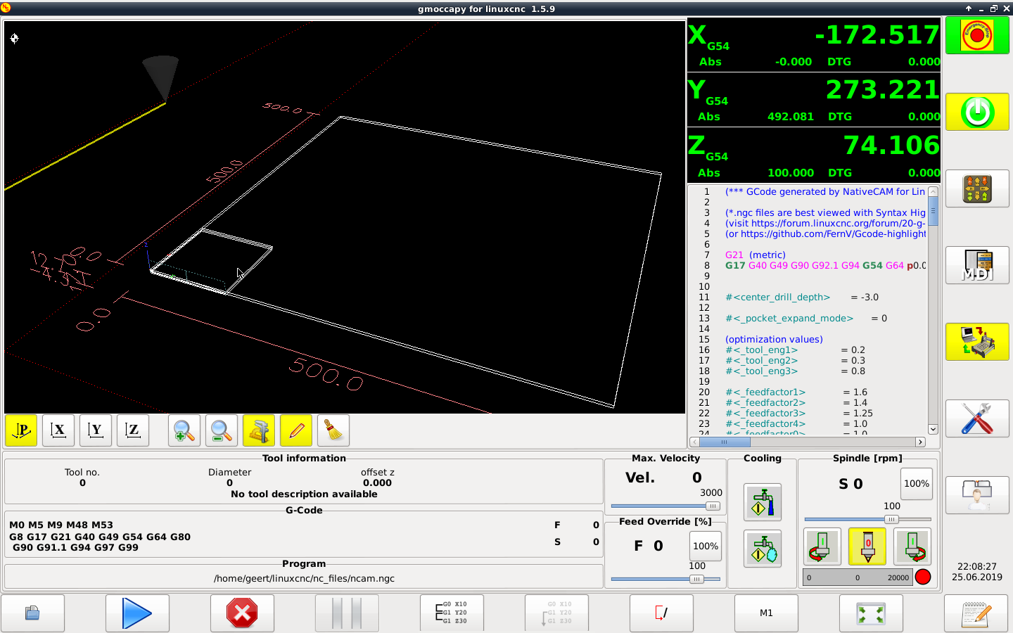

Hello,
I installed native cam and played around with some examples, and then made my own part. Just defined a workpiece, selected a mill from my tooltable and defined a rectangle (cut on the outside and through workpiece).
This little test as well as the previously opened examples appear on the preview screen exactly as expected. However, going into automatic mode (gmoccapy) and starting the generated g-code does absolutely nothing. I do not get any error message either.
Is there a way to see some kind of debugging info to see what is happening or why nothing happens?
Geert

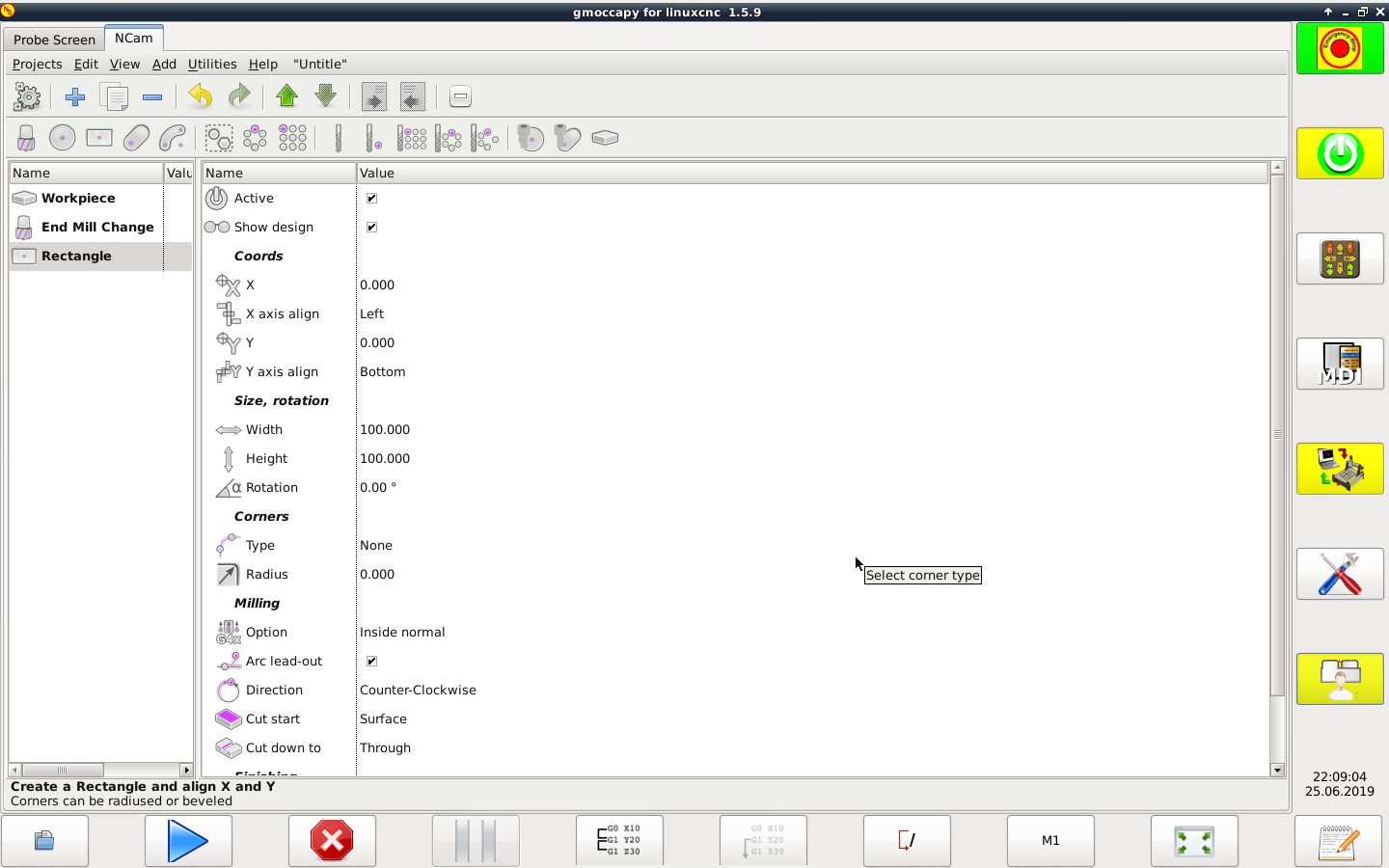

here are the screenshots and the G code as generated by nativecam
I defined a workpiecef of 500x50x3 and used tool number 4 from the tooltable
The generated G code:
The tooltable
Native CAM
The preview
The tooltable
Native CAM
The preview

Fern,
Thanks for the short and elegant reply....it was very effective!
I was convinced it had to be something obvious. Now I understand how the workpiece is displayed....
Geert
Geert
