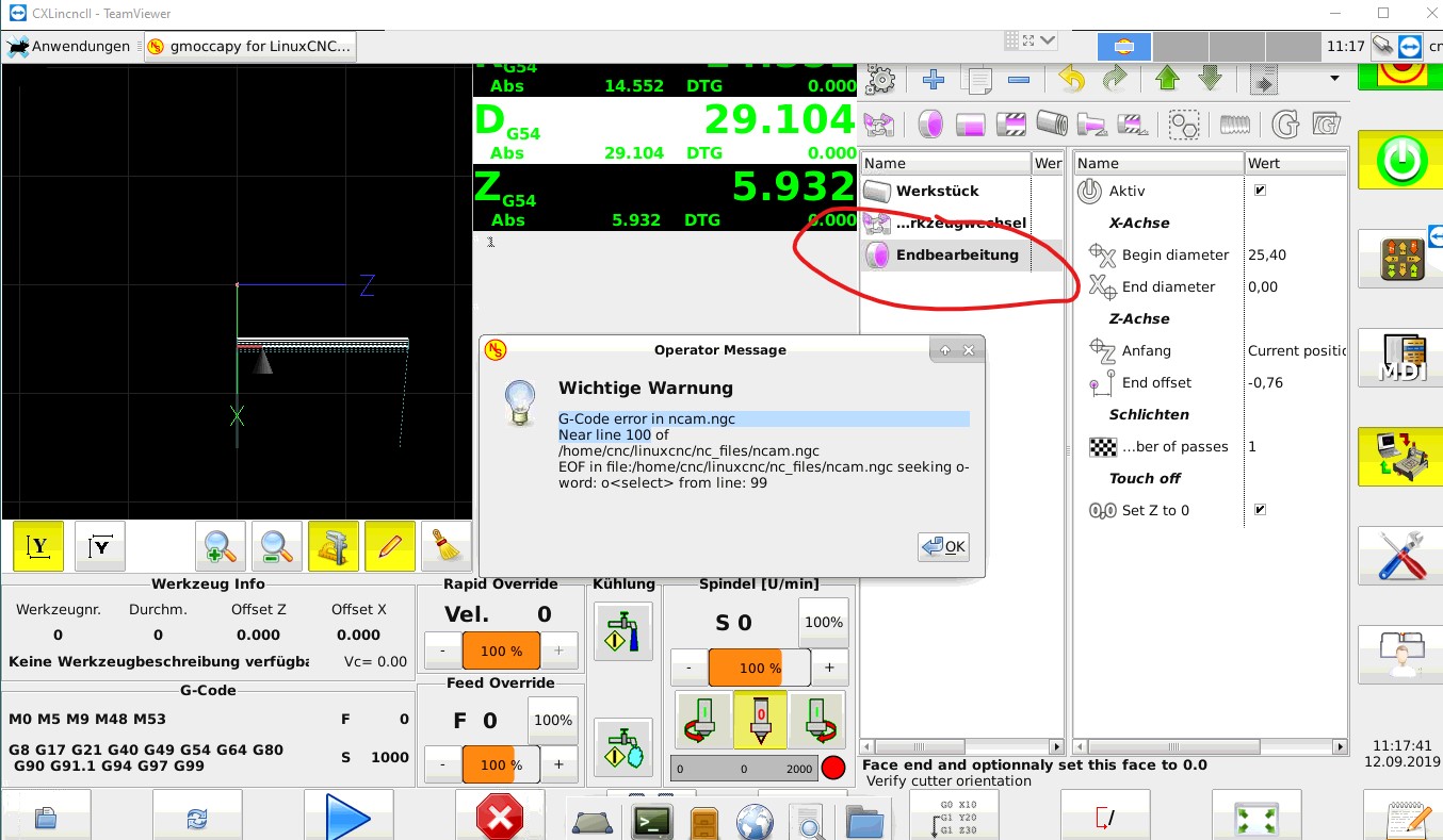

Hello I get the following error when creating a plane surface:
G-Code error in ncam.ngc
Near line 100 of
/home/cnc/linuxcnc/nc_files/ncam.ngc
EOF in file:/home/cnc/linuxcnc/nc_files/ncam.ngc seeking o-word: o<select> from line: 99
I have already worked on the following thread:
forum.linuxcnc.org/nativecam/35500-issue...h-1st-simple-program
new knowledge, if I put the bold line:
(begin Facing)
(author : Fernand Veilleux)
o<facing_002_act> if [1]
o<select> CALL [42] [1] [0.000000] [#<_z>] [0]
o<facing> CALL [25.400000] [0.000000] [#42] [#42 + -0.762000] [1] [1]
o<facing_002_act> endif
(end Facing)
remove to:
(begin Facing)
o<facing_001_act> if [1]
o<facing_001_act> endif
(end Facing)
program works.
Does my taplate have an error?
is unfortunately not a solution.

12 Sep 2019 13:42 #144965
by pl7i92
Replied by pl7i92 on topic G-Code error in ncam.ngc Near line 100 only Facing
ist da vileicht ein umlaut Buchstabe mit reingerutscht in den Namenswert
ncam nimmt nur utf-8

12 Sep 2019 18:17 #144978
by blue0cean
Replied by blue0cean on topic G-Code error in ncam.ngc Near line 100 only Facing
ok soeben überprüft:
es gibt im Programm nur den einen Umlaut unter der Zeile 20:
(Das ist eine eingebaute Sicherheit, um einen Einstich das Werkstück vermeiden zu helfen)
ich denke der Teil in Klammern ist nur ein Kommentar.
es wird die Zeile 99 moniert :

12 Sep 2019 18:34 #144980
by blue0cean
nun kann ich Plandrehen wenn als erstes Längsdrehe.

Hi
Sorry for the German as your Image showes GERMAN Readings i thaught to answer German
What version of Ncam is it and what version of Linuxcnc is it installed to
it seams there is a double O command in the output

13 Sep 2019 08:47 - 13 Sep 2019 11:23 #145036
by blue0cean
oh sorry that was my mistake i put the google overseer on the side. The double O command is stored in the templates of Ferm. Should we ask him if that is so ok?
github.com/FernV/NativeCAM/blob/master/cfg/lathe/facing.cfg
Linuxcnc 2.9.0 pre
Nativecam Version:
from this Paht
forum.linuxcnc.org/nativecam/32891-use-n...eb-package-now#94274
Linuxcnc 2.9.0 pre
Nativecam Version:
from this Paht

03 Apr 2021 09:35 - 03 Apr 2021 09:50 #204601
by HansU
Replied by HansU on topic G-Code error in ncam.ngc Near line 100 only Facing
@blue0cean How did you got it working?
I have still the same error when staring it stand alone:
Near line 93 of
/home/cnc/nativecam/scripts/ncam.ngc
EOF in file:/home/cnc/nativecam/scripts/ncam.ngc seeking o-word: o<select> from line: 92

06 Apr 2021 07:50 #205050
by blue0cean
Hallo Hansu,
lösche bitte mal das Standard Template und und erzeuge diese neu.
hier ist ein kleines Anwenderforum:
discord.com/channels/481172737981808671/763456622110179358

16 Apr 2021 15:29 #206111
by HansU
You mean?
Unfortunately deleting this didn't solve it.
nativecam/catalogs/mill/projects/default_template.xmlUnfortunately deleting this didn't solve it.

22 Apr 2022 01:14 - 22 Apr 2022 01:18 #240845
by alfcnc
Replied by alfcnc on topic G-Code error in ncam.ngc Near line 100 only Facing
Hello i have the same problem. I just come from install lastest Linuxcnc 2.8.2 Rtai kernel with the Debian 10 Buster linuxcnc iso and when LInuxcnc and settings finish all run very good So i want to test and install Nativecam with the apt methods with the trick of modify the repository from Buster to stretch in the apt source list... to be able to install on Buster (thanks to another users linuxcnc forums for this).
But but Nativecam run ...i can do about all the things in edit mode i was happy ..but when I try to output the ngc gcode to a file and try to load the ngc file on Linuxcnc this is always failed to load with the EOF errors...o-word: o<select>.
Did someone have found the solving trick ? Many thanks have a nice days.
