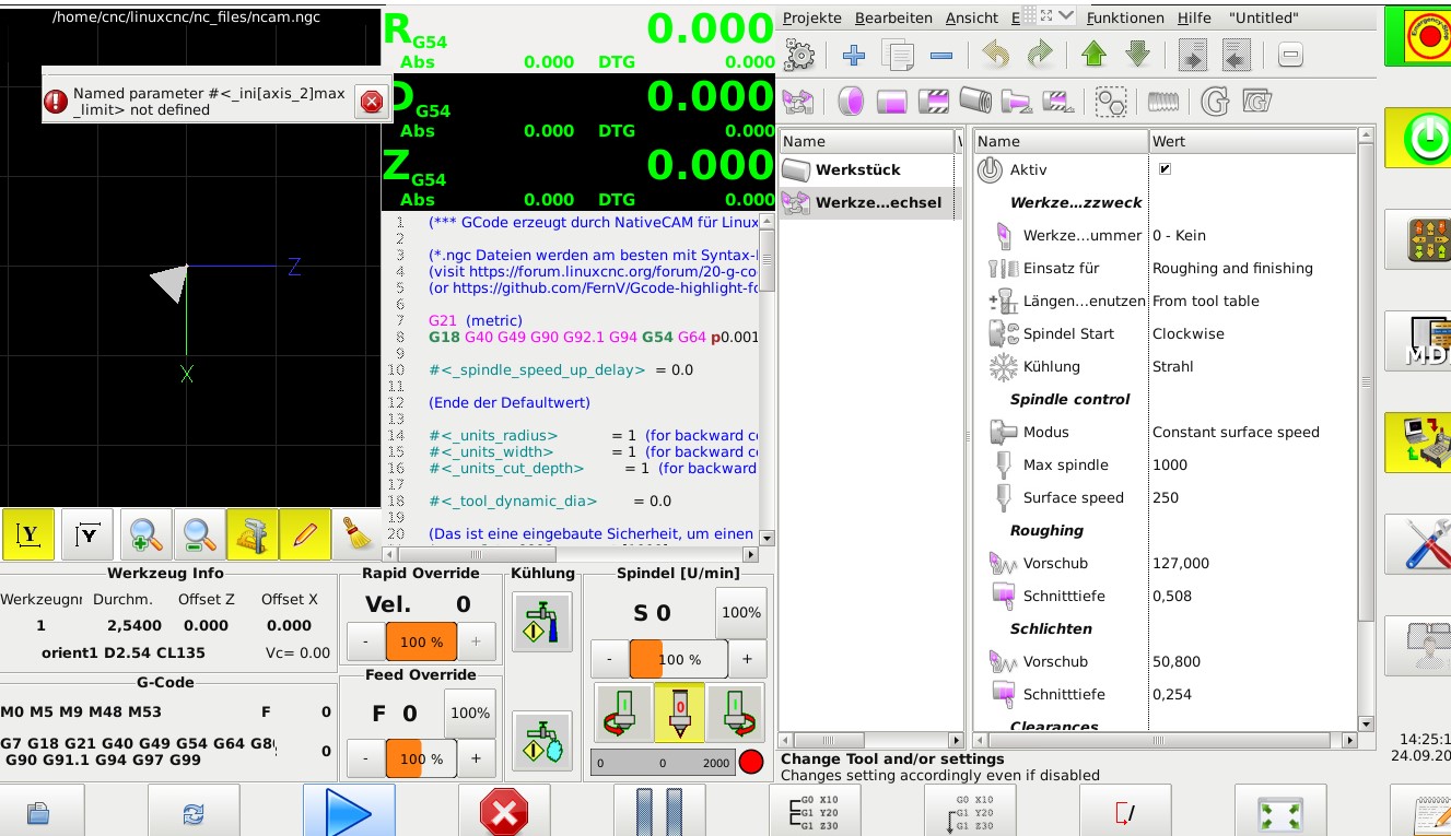

Hello Nativcam user,
has one of you an idea why this message when you submit the program the error message:
Named parameter #<_ini[axis_2]max_limit> not defined
Native Cam Version 0.1.14d
Linuxcnc 2.9
appears. It does not matter if I do not give up a task or a task like facing. Here is my ini.

24 Sep 2019 13:42 #146069
by pl7i92
Replied by pl7i92 on topic Named parameter #<_ini[axis_2]max_limit> not defined on Programm Start
seams you mixed up the valiues and Versions
so for your best guess is to just copy past

axis_2 is Z

[AXIS_0] <<<< this is wrong, there can not be axis 0, just joint 0
MIN_LIMIT = -10000
MAX_LIMIT = 10000
MAX_VELOCITY = 60
MAX_ACCELERATION = 20
axis_2 is Z

ok so adapted.
now I could limit it further, as soon as a tool <> 0 is selected, the error appears. Since the lathe tool table contains no XZ offsets, I have no idea yet.
ok so adapted.

16 Jul 2021 12:27 #215036
Replied by andypugh on topic Named parameter #<_ini[axis_2]max_limit> not defined on Programm Start
I think that this is a side-effect of the changes in 2.8 which changed some parts of the INI layout.
Try changing [axis_2] to either [axis_Z] or [joint_2]
