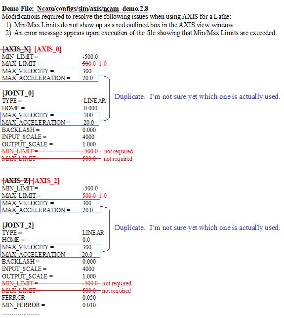

X & Z Min/Max Limit Error with NCam Embedded in AXIS GUI for a Lathe: Resolved was created by Barry
...Just sharing what I learned to help others....
I recently embedded NCam into the Axis GUI for a Lathe and to demo it, I used the ncam_demo.2.8.ini file located under ....Ncam/configs/sim/axis/ncam_demo.2.8. After completing a part using NCam I clicked on the AXIS Icon to execute the file and got the error message "X & Z axis limits exceeded." I then noticed that the machine limits were not indicated by a red outline box in the AXIS GUI view window. The attached document shows how to resolve this issue. Just change the .ini file, the following headers:
Change [AXIS_X] to [AXIS_0] and Change [AXIS_Z] to [AXIS_2]
I hope this helps folks because it took me a while to figure this out.

Resolved
