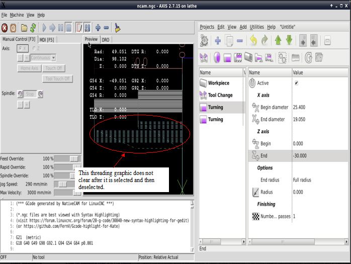

Fern, I noticed that there was a graphics bug in the NCAM AXIS Lathe Setup. The attached document details the issue. When External Threading is selected the threading cycle graphic appears on the AXIS screen showing the tool path. However, if you then decide not to thread and delete the threading step, the graphic in the AXIS screen does not clear. Can you please take a look at this or let me know how to fix it?

The python command for cleaning up the gremlin :
gremlin.clear_live_plotter()
or
self.widgets.gremlin.clear_live_plotter()
Maybe you can put is somewhere in the ncam code.
or

Hi guys,
I doubt this is an issue of ncam as such, because the interface is the generated NGC file, not any "drawing" as such done by NativeCAM. The backplot is done based on the generated NGC file only. I tried to reproduce the same in 2.8 with gmoccapy, which uses the same gremlin, once with threading and then deactivated it -> no issue.
Regards,
Daniel
