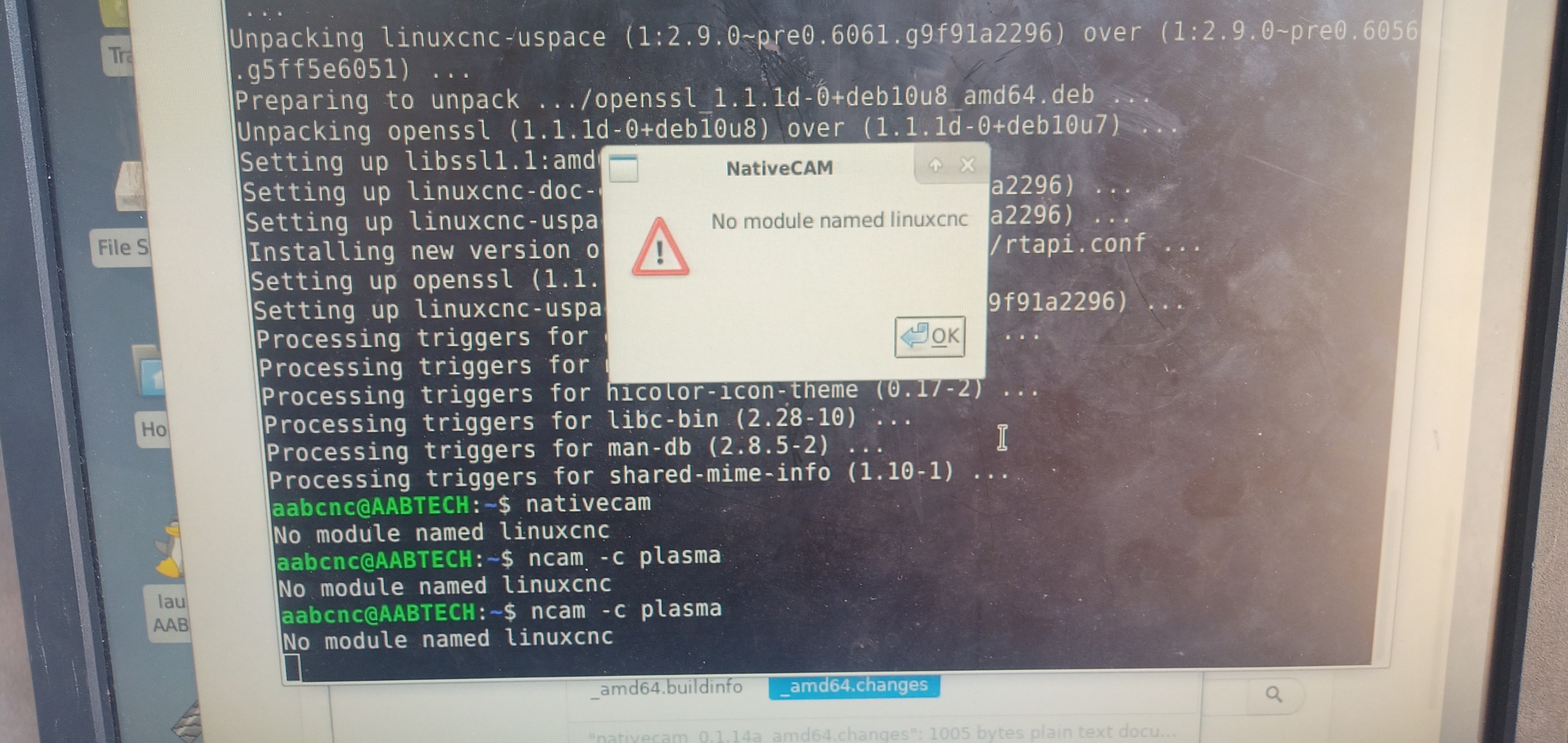

17 Mar 2022 11:35 #237528
by aabtech
Native CAM can't open was created by aabtech

27 Mar 2022 12:50 #238456
by robertspark
Replied by robertspark on topic Native CAM can't open
depending upon how you installed nativecam it asks you if you have a run in place or full installed linuxcnc install.
I suspect that is the issue.
note the nativecam won't work with master 2.9 or bullseye as it is still python2 and GTK2... and these are no longer used with mater / 2.9 or bullseye... so it simply doesn't load

27 Mar 2022 12:52 #238457
by robertspark
I have just looked again at the screenshot and you have 2.9 listed. that will be the problem.
nativecam will run with 2.8.2 just fine on buster. but not on bullseye
