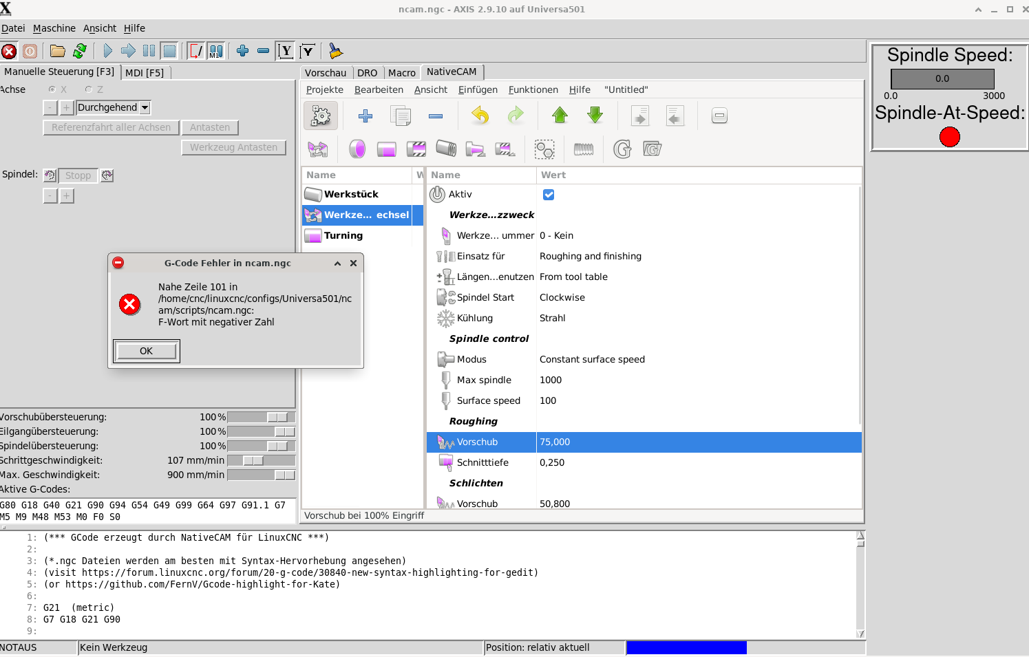

06 Aug 2026 17:08 #348499
by BigDo
Replied by BigDo on topic NativeCAM 2.0b — Python 3 & GTK3 port for LinuxCNC 2.9 / Debian 13 Trixie
- MaHa

06 Aug 2026 17:28 #348500
by MaHa
Replied by MaHa on topic NativeCAM 2.0b — Python 3 & GTK3 port for LinuxCNC 2.9 / Debian 13 Trixie
Feed per revolution too high ?

06 Aug 2026 19:13 #348504
by BigDo
Feed 75,00
i used this settings long before.

06 Aug 2026 20:19 #348507
by tuxcnc
Replied by tuxcnc on topic NativeCAM 2.0b — Python 3 & GTK3 port for LinuxCNC 2.9 / Debian 13 Trixie
This is conflict with lathemacro.Negative F-WORD at Line near 101
Does anyone have any ideas?

06 Aug 2026 23:44 #348513
Replied by tommylight on topic NativeCAM 2.0b — Python 3 & GTK3 port for LinuxCNC 2.9 / Debian 13 Trixie
F-WORD = F = feed rate, it can not have a negative value as far as i know, although there might have been talks about that for EDM probably, but i do not recall the end result.

07 Aug 2026 11:04 #348525
by BigDo
You're right. That was the cause of the error.
Thank you very much.
