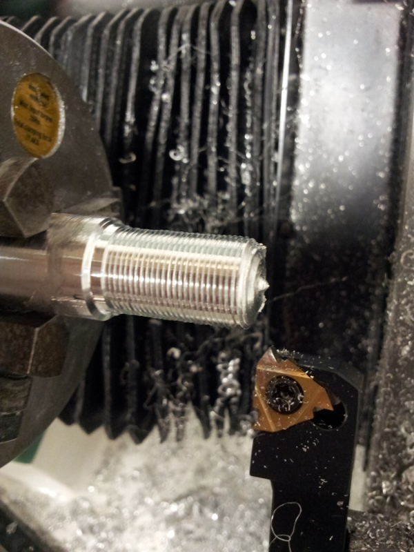

- Iron-Man
- Posts: 70
04 Dec 2015 03:31 #66352
by Iron-Man
After talking to Peter at MESA, I did not need the (a,b,z) outputs for threading, only position and index. I have threading functioning!!
Now I just need to tidy up the wiring and enclosure.
I would like to ask the question, when gcode is running in pathpilot lathe, does the rpm show in the RPM window?
Thanks for all the help everyone.
Iron-Man

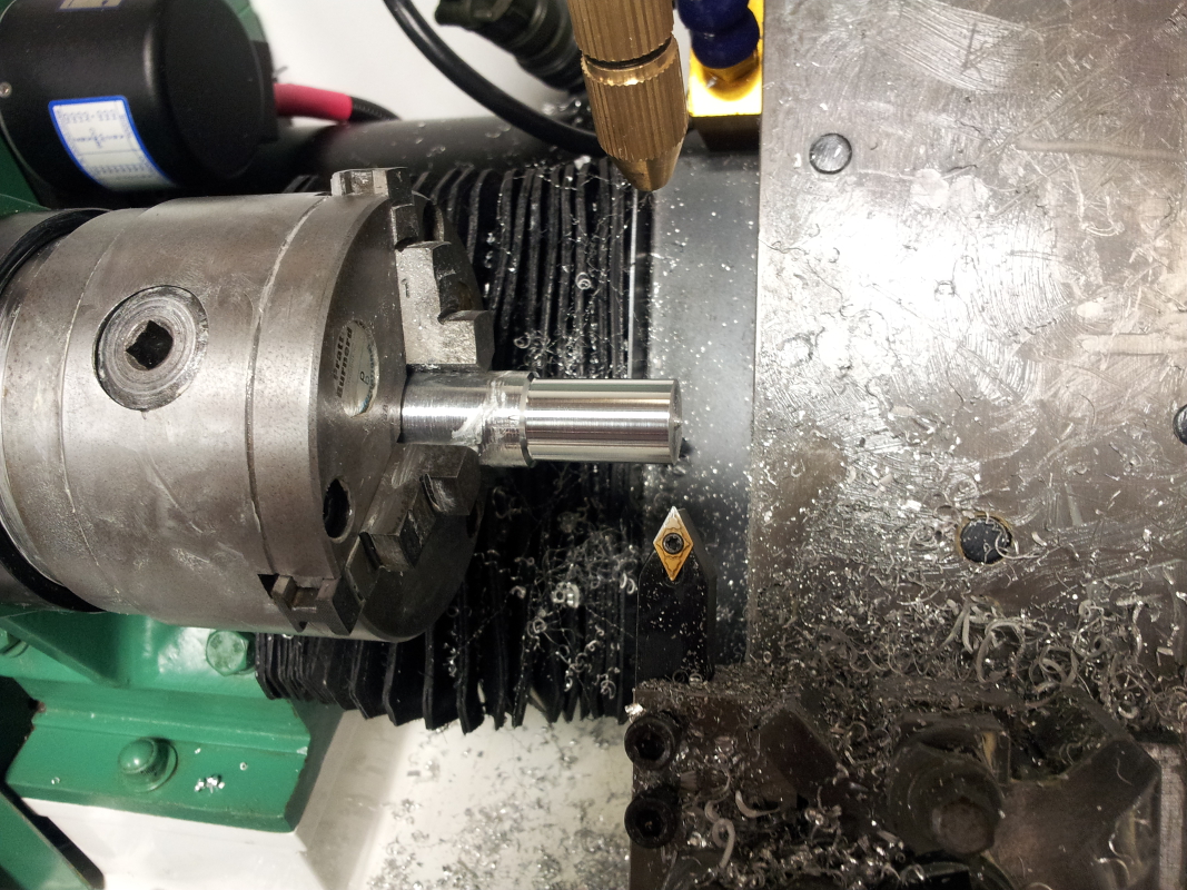

- Iron-Man
- Posts: 70
11 Dec 2015 23:06 - 11 Dec 2015 23:08 #66852
by Iron-Man
Replied by Iron-Man on topic PathPilot on AMD GizmoSphere 1
Last edit: 11 Dec 2015 23:08 by Iron-Man.
- cncbasher
- Posts: 1021
- Thank you received: 202
12 Dec 2015 13:16 #66864
by cncbasher
Replied by cncbasher on topic PathPilot on AMD GizmoSphere 1
but does the Nut fit ! LOL
looks fine , good work so far
