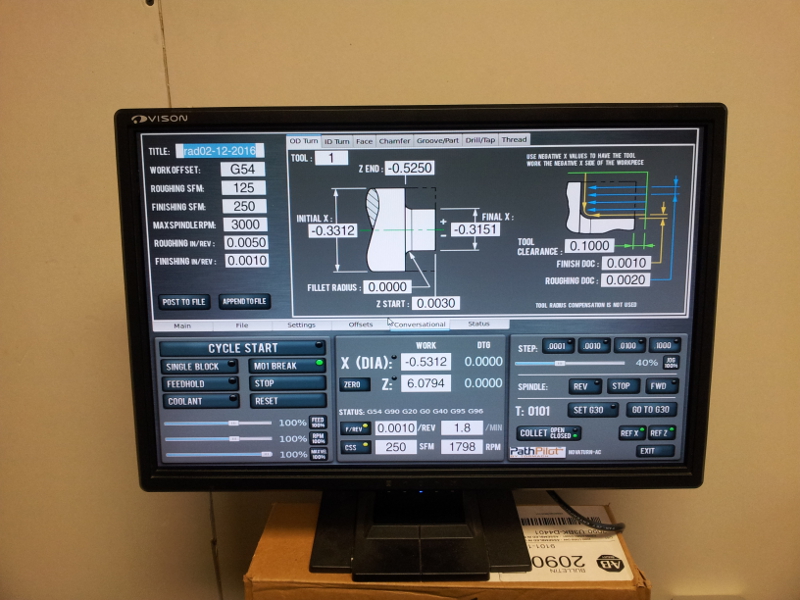

The Denford NovaTurn uses Inductive Sensors, BES 517-352-NO-L. I currently have them functioning in PathPilot. X and Z reference works correctly and also sets the soft limits.

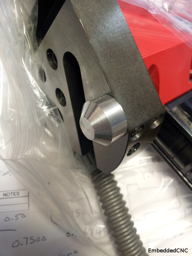

I had to change out the Denford tool post to a AXA style quick change tool post. Now I can follow the 15LSlant-Pro videos for tool offsets and set-ups. I am still looking for a suitable auto tool changer to modify for this lathe. Initial test cuts look promising. Initial diameter 0.3312 wanted 0.3151( Yaskawa SGMP motor shaft diameter), measured with micrometer 0.3153, delta = 0.0002.
Just to make it clear, I am running PathPilot on this system.
Iron-Man

Why? It should be entirely possible to use the Denford changer with LinuxCNC or PathPilot
Replied by andypugh on topic PathPilot on AMD GizmoSphere 1

The Denford tool changer was not complete. No additional components, only one tool holder.
I do not think that parts can be purchased for this style of manual tool changer.

Ah, I was assuming you had one of the Denford automatic tool changes.
I thought that the Denford manual toolpost was a perfectly standard Dickson style?

Andy I did not know it was a " Dickson style" tool changer. If I can only find a Denford auto tool changer or suitable one, I will be set. It looks like I will have to machine one, when the Triac is refitted and running.
