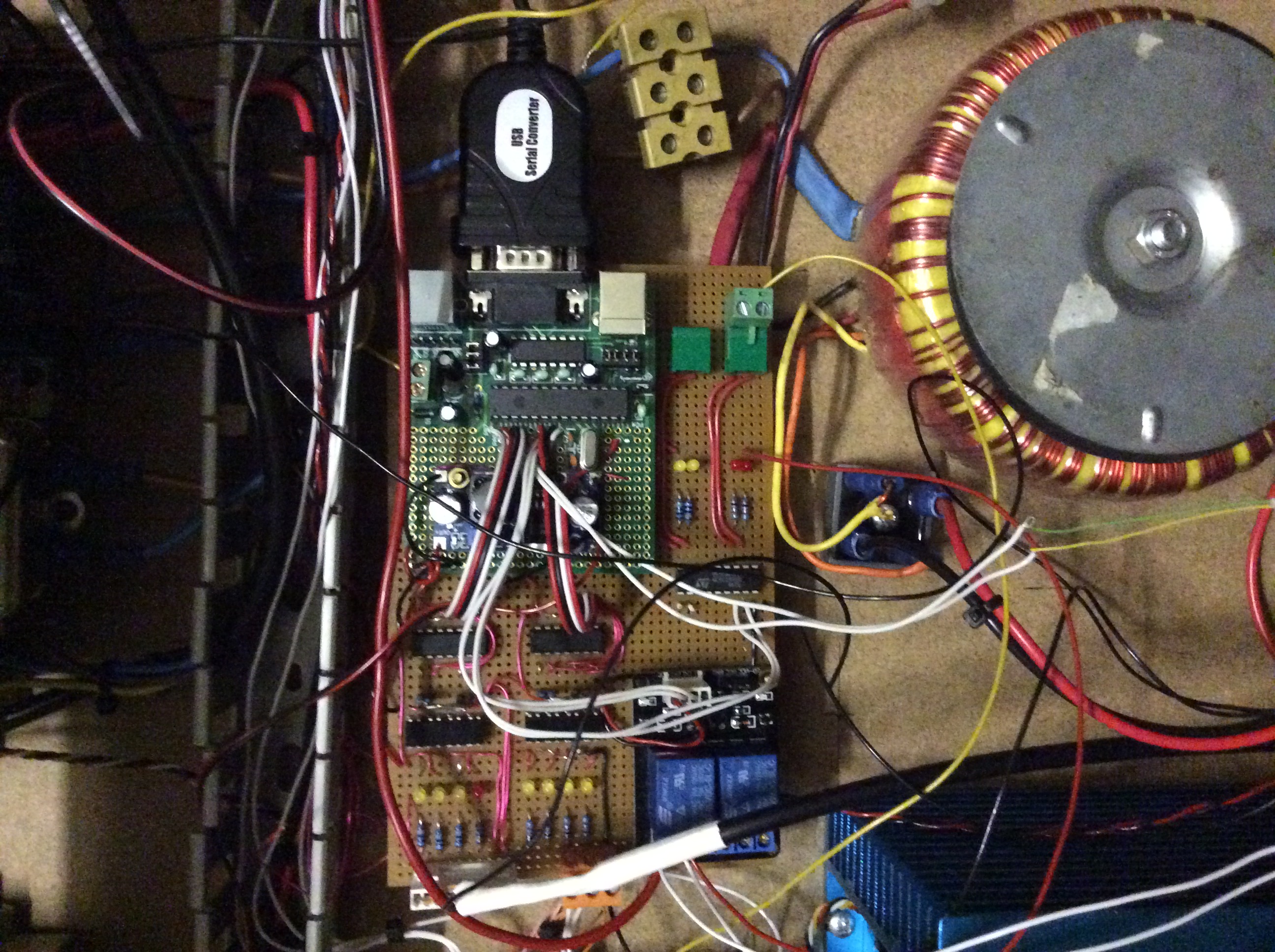

Hello
I have developed an 8 position toolchanger for my lathe I am using a 5i25 and 7i76. The bit files that come with the 5i25 are set up to produce 5 step and direction channels. I have used a pic micro to decode the pwm signals produced by PathPilot but had to implement a software pwm gen. Is it possible to change one of the step and direction channels to a hardware pwm. Has anyone already done this or could explain how this is done or should I contact Mesa ???

Will have a look at the pins later. PathPilot outputs a pulse width relevant to the tool number I have programmed the following using the capture compare registers on a pic and a timer. Works Perfect.
rise = get_capture(1); // CCP_1 is the time the pulse went high
fall = get_capture(2); // CCP_2 is the time the pulse went low
The times are in Milliseconds for 1ms the range is 900 to 1050 as the PWM gen is software generated it gitters around a bit hence was wondering if I could get a more stable hardware PWM signal.

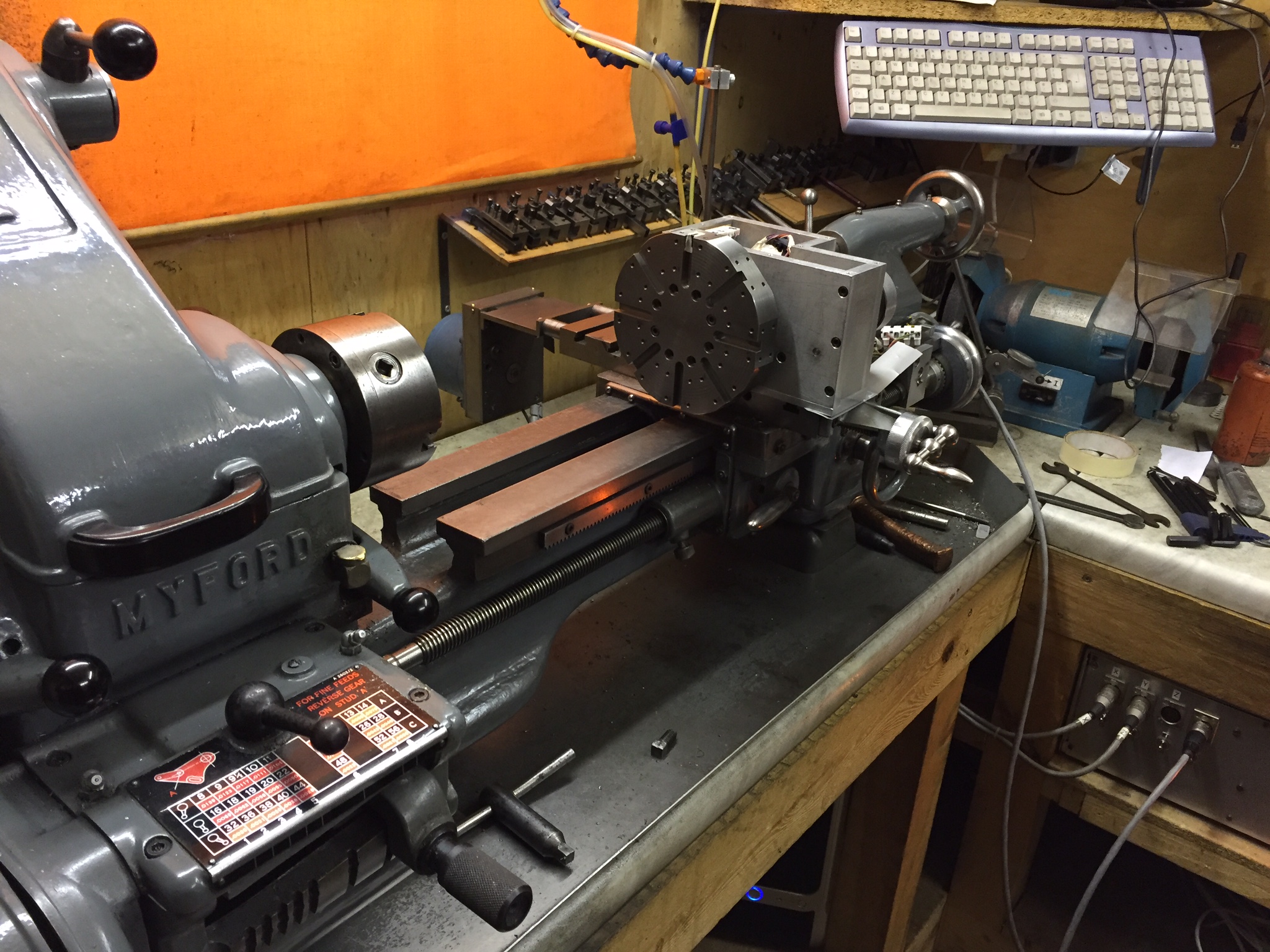

20 Jan 2016 20:31 #68848
by micknucam
Replied by micknucam on topic PathPilot controlled lathe toolchanger
Thanks CNCBASHER the bit file works fantastic the pwm signal is rock solid have done some testing and all is great. Glad I could help with the setup of PathPilot have put a picture of the toolchanger mounted on George's myford lathe.
