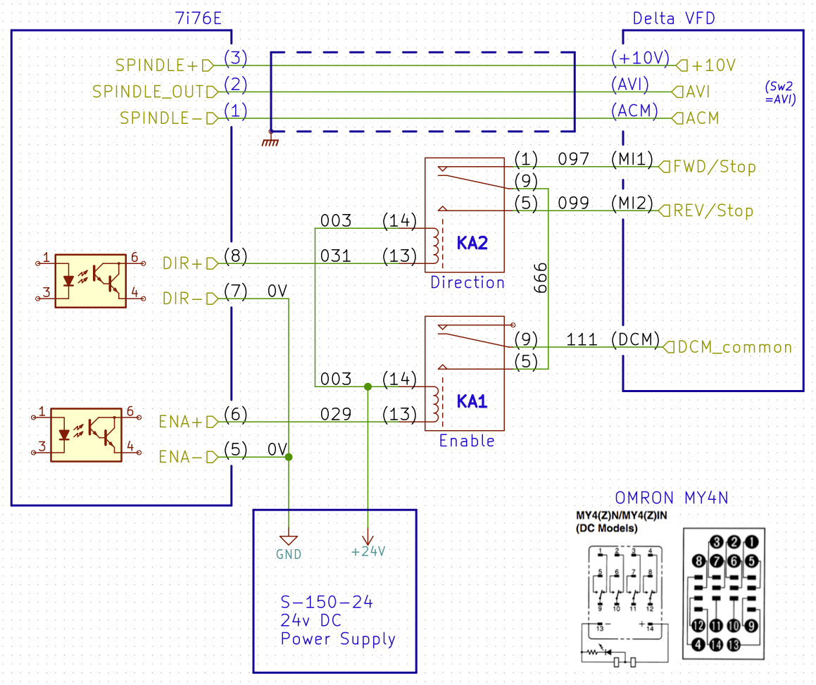

With GREAT help from generous strangers, my brothers, and local friends with virtual masters degrees in everything tech, I've installed LinuxCNC 2.7 onto Mint, wired the Mesa 7i76e, and used PNCconf to configure it all and everything seems to be working fine... so I'm very happy. I'm still learning the differences of how LinuxCnc does things compared to Mach3, but its coming along. I have yet to work on mounting hardware for theMarathon inverter motor and installing the Durapulse VFD. Currently I'm using the Delta VFD with the inverter motor that came with the mill from the factory. I believe the wiring for both VFD's is very similar if not identical ( sans the encoder ). Its been a long haul of many late nights but in the end its well worth it.
Something that may help you with your wiring, perhaps, is this wiring diagram for the 7i76e that my brother made for me to use. I couldn't find the model you noted in your reply ( 6i25e doesn't pop up when doing a search ). I intend to create a thread about what I've learned ( from a noobs perspective ) regarding the wiring of the 7i76e. Although I'm not sure, I assume that the 7i76's wiring is similar to the other Mesa products wiring, or is that wishful thinking ? anyway...
I need a little time now before I tackle PathPilot... the above was a little more stressful than I'd like to admit and impossible without the help of my brother, PCW, and also cncnoob1976's tutorial and help :
forum.linuxcnc.org/9-installing-linuxcnc...-or-deb?limitstart=0
note that KA1 and KA2 are two OMRON relays.
Cheers,
Jake

My brother and I looked at the Masso, its very appealing and my brother is still considering it. One thing, however, that needs to be answered, is : Does the Masso have enough headroom to handle many axis simultaneously ? It may, but imho, its one thing to find out before making the large investment.
PathPilot still looks like a worthwhile goal imho. It looks like the best interface of them all but if you want to get it all up and running overnight, the Masso looks like the ticket.
If you decide to try install linuxcnc onto Mint, and you are willing to use the command line / terminal it isn't so bad. I just ran into an issue with dependencies, which required the most "hand holding." Luckily I got some great help that I might be able to pass it along, if there aren't too many curve balls !
