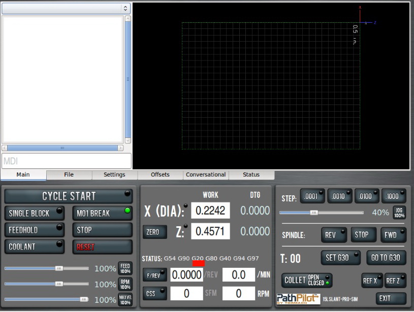

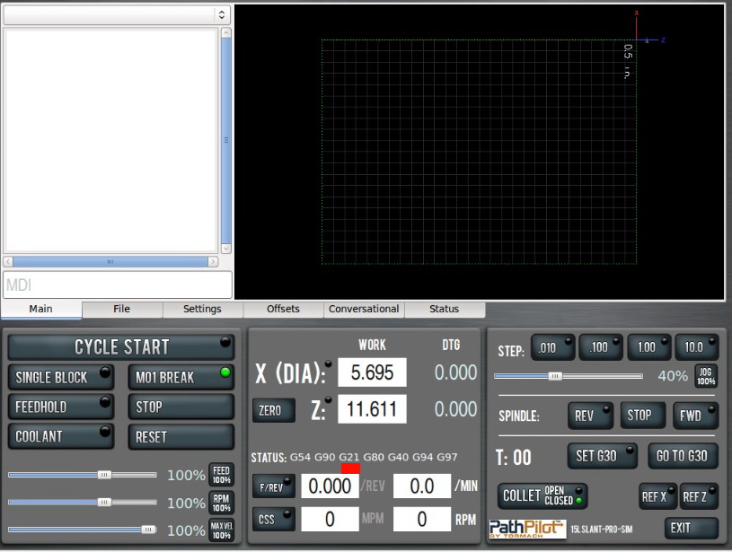

Maybe someone came across this. The DRO is displayed incorrectly. Before pressing the reset, everything is displayed correctly G21 and dimensions in mm. After the reset itself it goes to G21 and displays inches. This is only in the lathe configuration. In the configurations, the milling cutter works fine.

change only this
ini ........
RS274NGC_STARTUP_CODE = G7 G18 G21 G90 G64
ini ........

Thanks dinkata. It helped.
