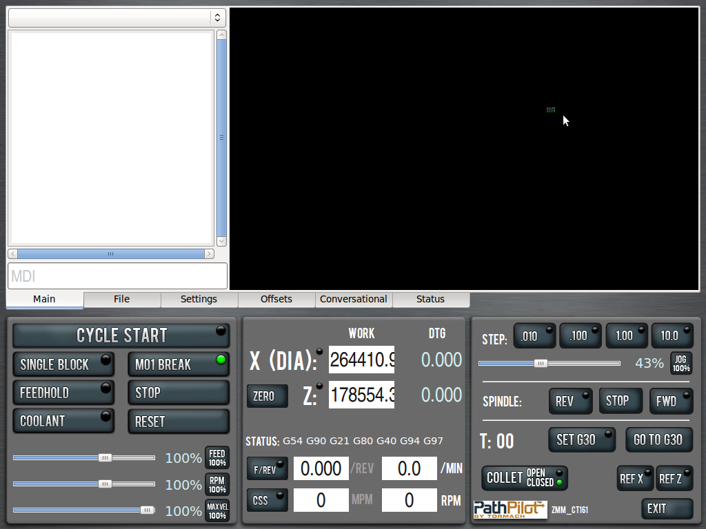

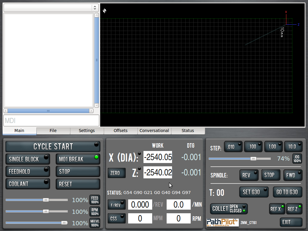

I try work Lathe PathPilot with Mesa 5i25 + 7i77.[This config work with Linuxcnc 2.7.8 ]
How to change all in metric system ? I try..
tormach_lathe_ui.py:inibut very little field work start up :
DRO show mm *25.4 !!??Here command G0 X-50 Z-100
Classicladder work ! Home work ! There is still work
Sorry for my language , i use google transalator
return 1.0 if self.g21 else 25.4RS274NGC_STARTUP_CODE = G7 G18 G21 G90[TRAJ]....LINEAR_UNITS = mmDRO show mm *25.4 !!??Here command G0 X-50 Z-100

I changed the INI file, in the [RS274NGC] section change the line
RS274NGC_STARTUP_CODE = G8 G17 G20 G90 G64
to
RS274NGC_STARTUP_CODE = G8 G17 G21 G90 G64
No changes to TRAJ section.
Now all UI displays and buttons are metric, but unfortunately all the values in the INI file still need to be imperial, I'm comfortable with either so it's not really a problem for me.
g21 appears 38 times in the current mill UI so not sure what your one line python change does.
Ken

Path pilot runs on imperial and changes to metric as it needs. Everything in the ini file needs to be imperial, just the G21 line in RS274NGC is needed. I run my router on mm btw....

rafferty , racedirector Thank you for your participation.
I would like to know does anyone work PathPilot_5i25+5i77 .
I set ini
but when you move axis error : axis.0 following error .Maybe I can set up PID ?
This config work with Linuxcnc 2.7.8 .These are the PID settings :
I set ini
Warning: Spoiler!
Warning: Spoiler!

- dinkata
- Posts: 101
21 Feb 2017 08:43 - 21 Feb 2017 14:19 #88422
by dinkata
Replied by dinkata on topic Lathe__PathPilot_5i25+5i77
First step ready
it's in progress cycle:
o100 do
M66 P0 L0
o101 if [#5399 NE 1]
G91 G1 X50 Z50 F1000
G4 P2
G91 G1 X-50 Z-50 F1000
G4 P2
o101 else
o100 break
o101 endif
o100 while [#<_task> NE 0]
M2
Last edit: 21 Feb 2017 14:19 by dinkata.
