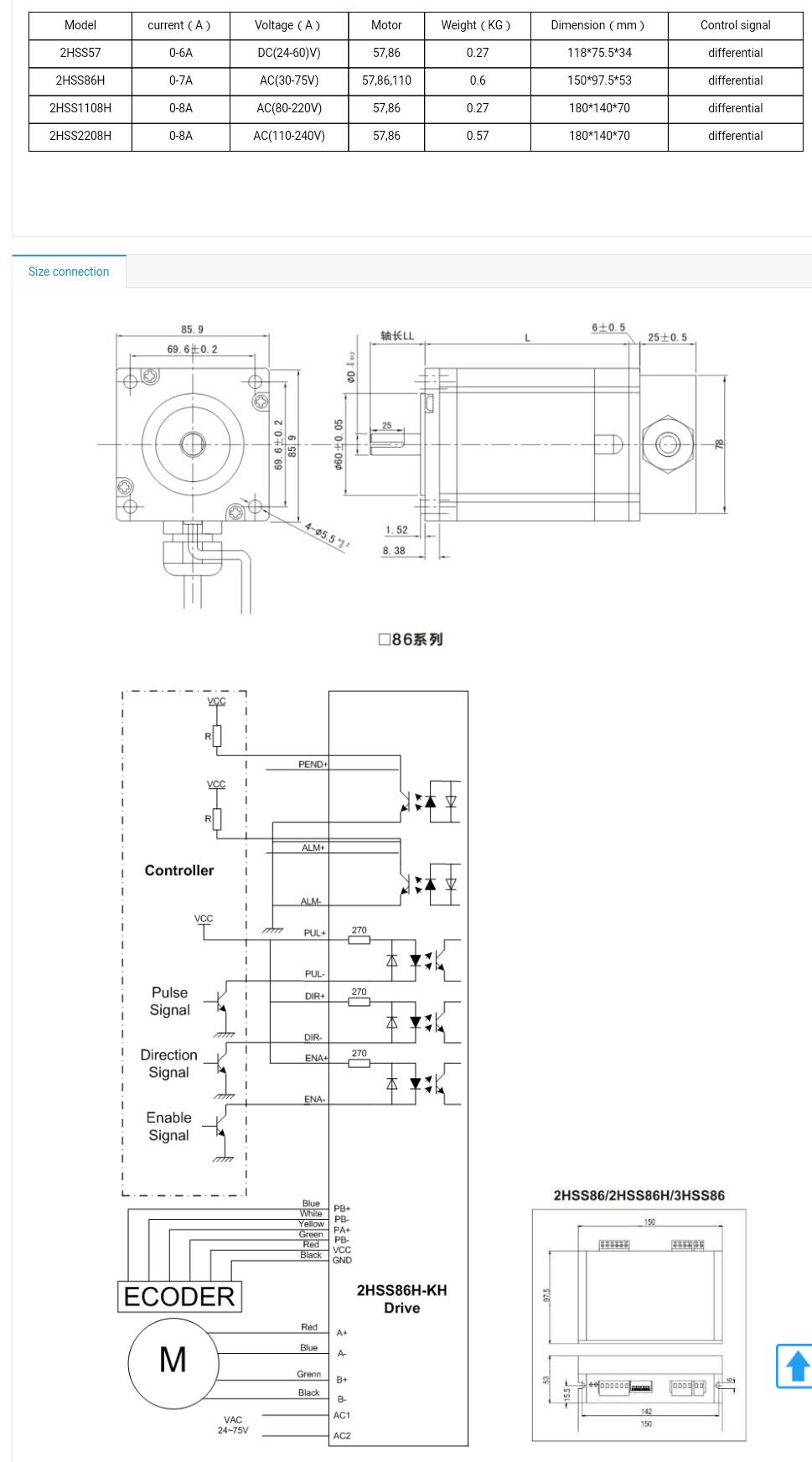

15 Mar 2017 21:02 #89711
by Lcvette
This is the information I found for my motors and drives, I'm not sure if they are ok to run +/-10v. Maybe you see something I don't?
Replied by Lcvette on topic Schematic Review Request
2 things, Mesa has diferential outputs for step and direction, so that is +-10V, not 5V, some drives (most) are 3.3 or 5V only so you have to use only dir+ and step+ OR dir- and step- and wire the other wire to gnd or +5V respectively. Or just make sure they can handle 10V.
Also i would not power the switches through the Mesa board, wire them to power supply through a fuse.
The rest is good.

15 Mar 2017 23:09 #89723
by Lcvette
The information I posted I see says differential, and 5v or 24v, but I don't see anywhere that it states +/- 10v. Sorry if this should be simple, but I've always wired it the other way. But I see it states that differential is better in the manual and if these drives can be wired that way I would like to do so.
Thanks!
Chris
Thanks!
Chris

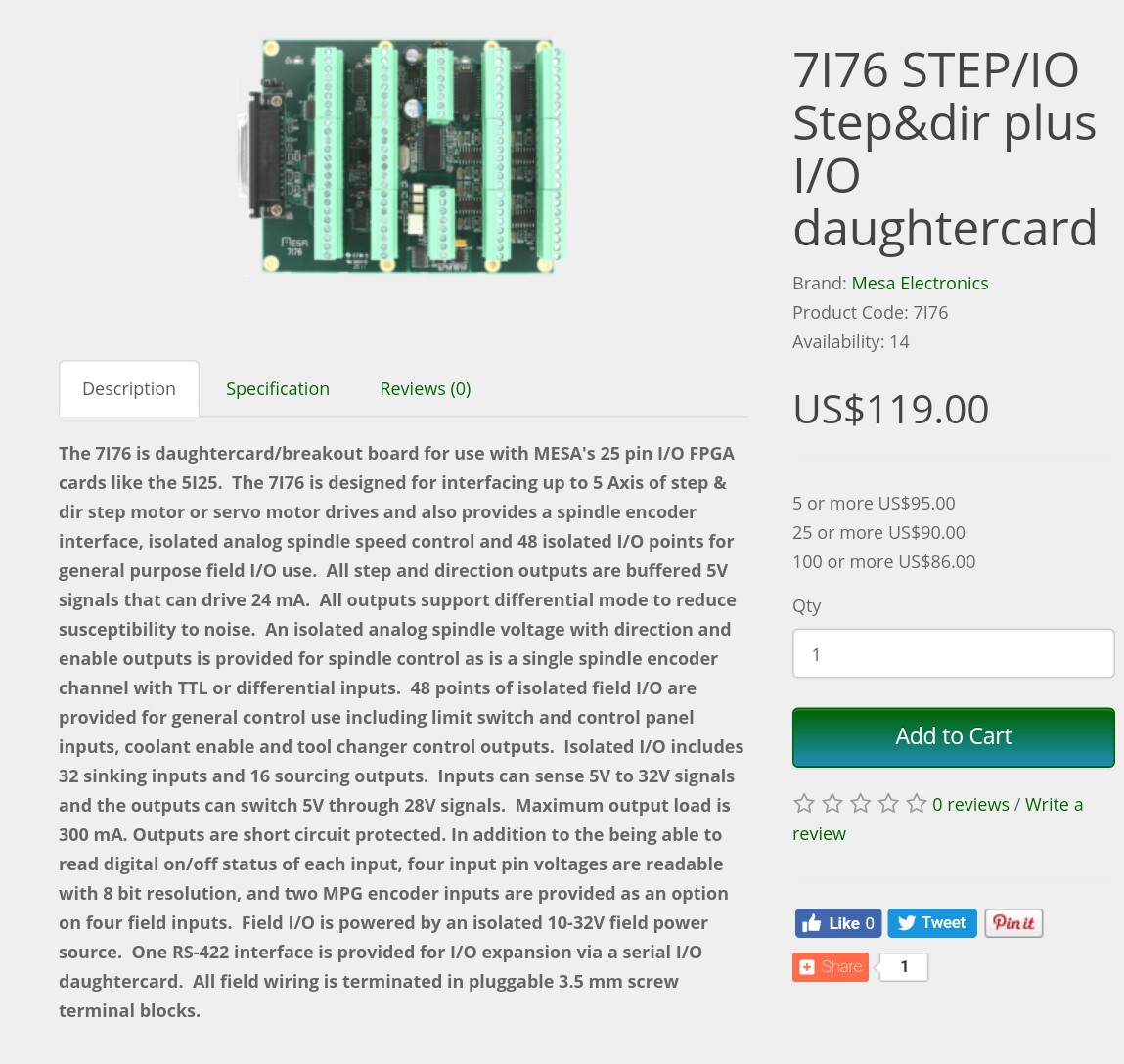

16 Mar 2017 02:39 #89730
by Lcvette
Ok after a long time searching, i found this blurb in the description... And it states that all step and direction outputs are 5v....... And my drive state they support differential so I'm going to assume I am good to go to write the step drives as shown. I wil correct the sensor voltage connections direct to the 24v power supply as instructed!
Thanks again for the extra eyes!
Chris
Chris

16 Mar 2017 04:38 #89734
Replied by tommylight on topic Schematic Review Request
You are good to go. They can go up to 24V so no worries.

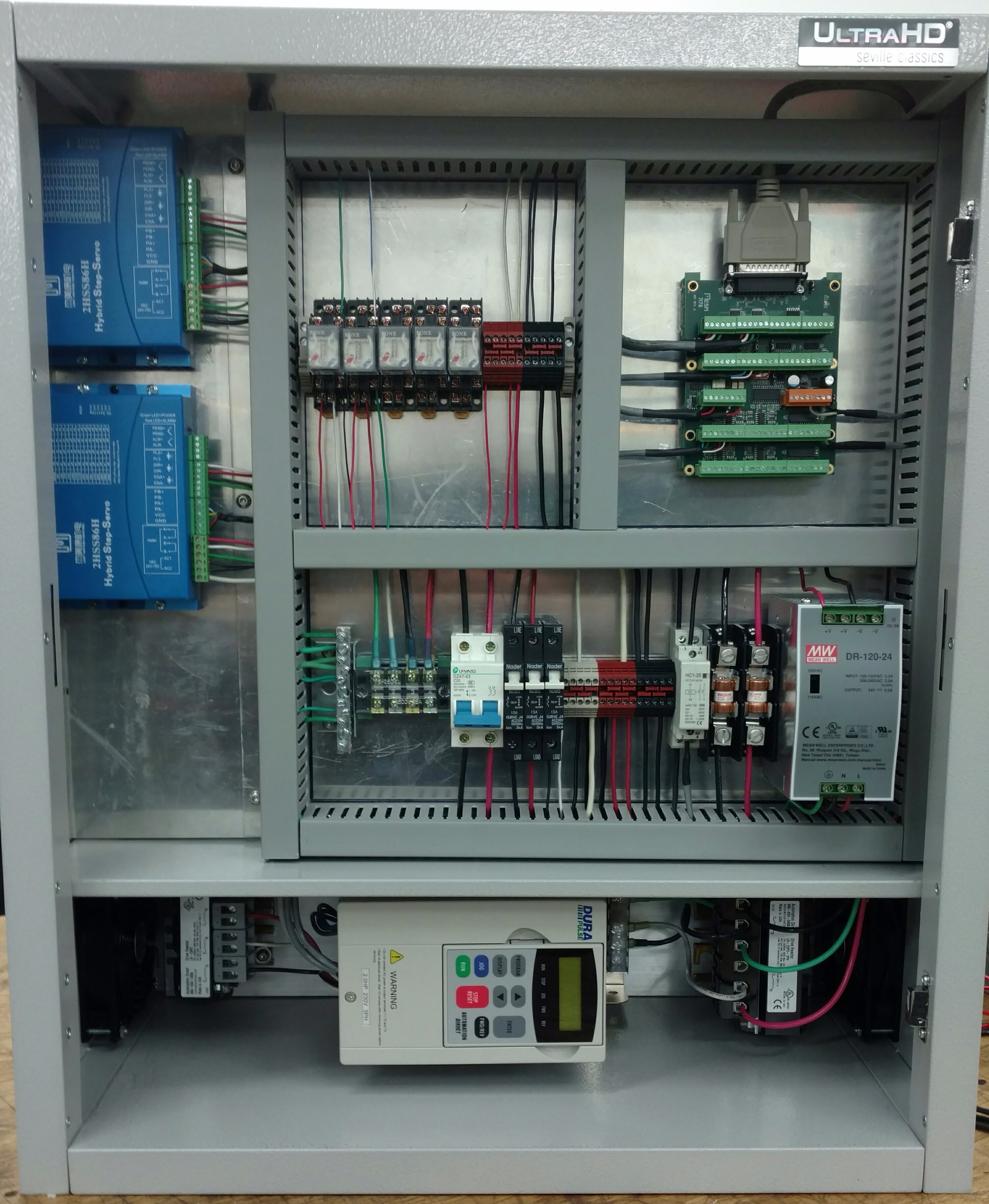

19 Mar 2017 22:27 - 19 Mar 2017 22:36 #89923
by Lcvette
Last edit: 19 Mar 2017 22:36 by Lcvette.
- brianTruck
- Posts: 99
- Thank you received: 6
20 Mar 2017 15:55 #89965
by brianTruck
Replied by brianTruck on topic Schematic Review Request
wow,
Nice clean job!
Brian
Nice clean job!
Brian

20 Mar 2017 15:57 #89966
by Lcvette
Thanks Brian! now if i understood the next steps I could make it more than a bench ornament..hahaha
wow,
Nice clean job!
Brian
