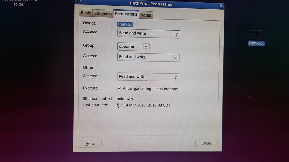

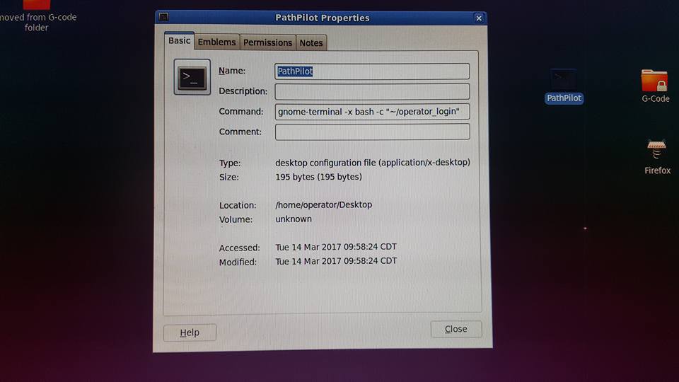

- Andyf97
- Posts: 7
24 Mar 2017 14:45 #90225
by Andyf97
Replied by Andyf97 on topic How to stop computer restart when closing Pathpilot
Shift+alt on boot will drop you to Gnome instead of the PathPilot application, then you can remove pathpilot from auto starting up at bootup and use all the features of ubuntu just like any other computer. Doing this also stops the machine to re-start at exit of pathpilot.
I have a shortcut on the ubuntu desktop to start pathpilot. I can acces the internmet, print files, copy g-code from my cad computer directly to the foilder pathpailoit uses for g-code.
Makes my life a dam hell of easier.
- bw4257
- Posts: 11
22 May 2017 14:25 #93499
by bw4257
Replied by bw4257 on topic How to stop computer restart when closing Pathpilot
How do you create the shortcut or more specifically start pathpilot from the desktop?
I tried opening a terminal and typing "linuxcnc" but that gave me an error about path not found or something of that nature.
Sorry to hijack this thread, but this was as closely related to my question as I was able to find
