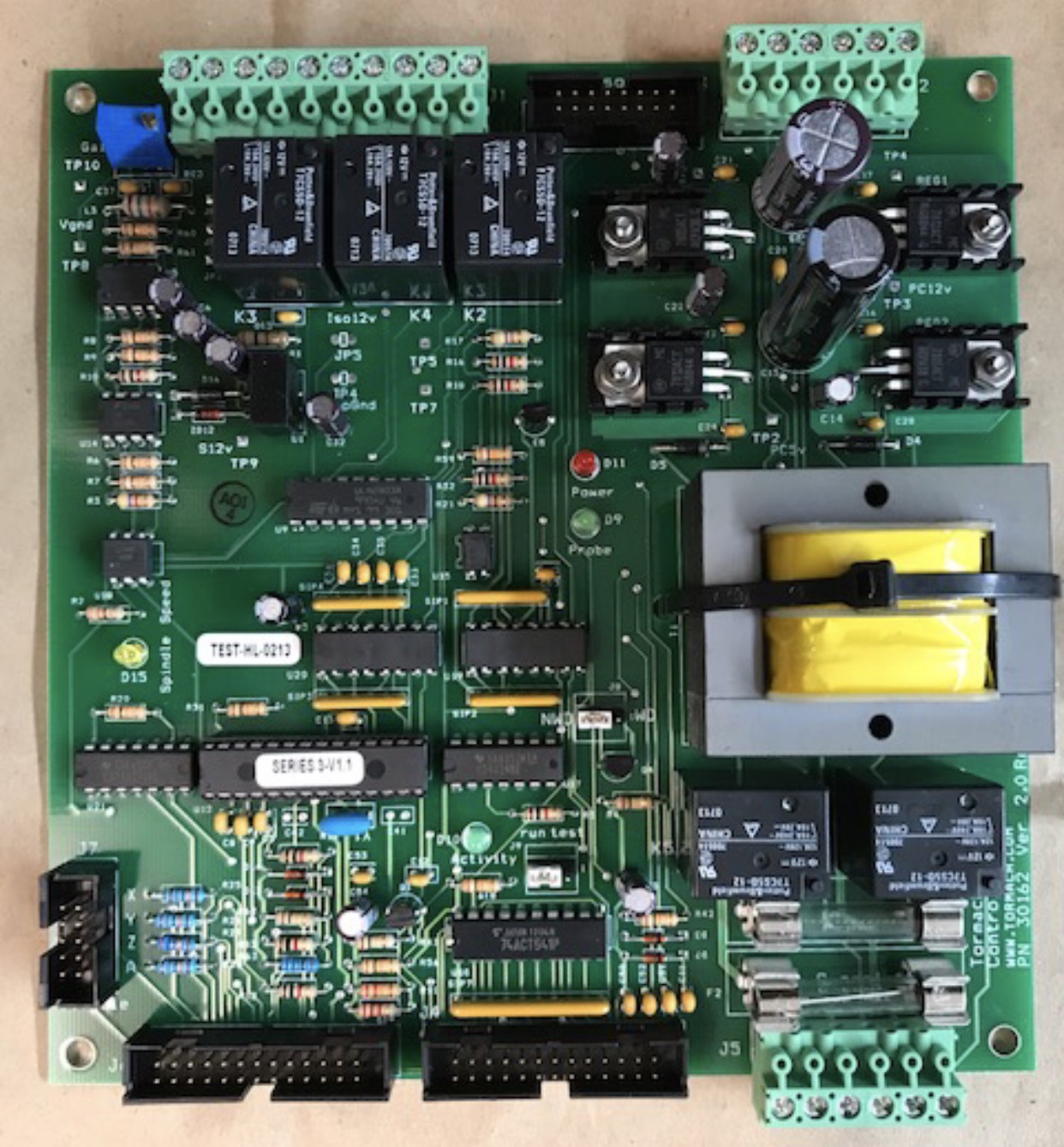

I own a Tormach 1100 mill. I upgrade the motors and VFD and ended up with a extra machine control board. www.tormach.com/store/index.php?app=ecom&ns=prodshow&ref=31045
I also upgraded to PathPilot, I bought the $715.00 controller and have a restore CD.
I'm building a PC to mirror the PathPilot controller to the "T". I have a Fadal TRM with dead contol.
My plan is to run it with PathPilot and use ClearPath motors. I see a lot of guys digging deep into PathPilot to make it work on non Tormach machines.
Since I have a control board will I have all the issues everyone else is having getting PathPilot to run another machine?

Could I ask a big favor?
Could you take some good high res close up shots of the board (both sides) and send to me or post them?

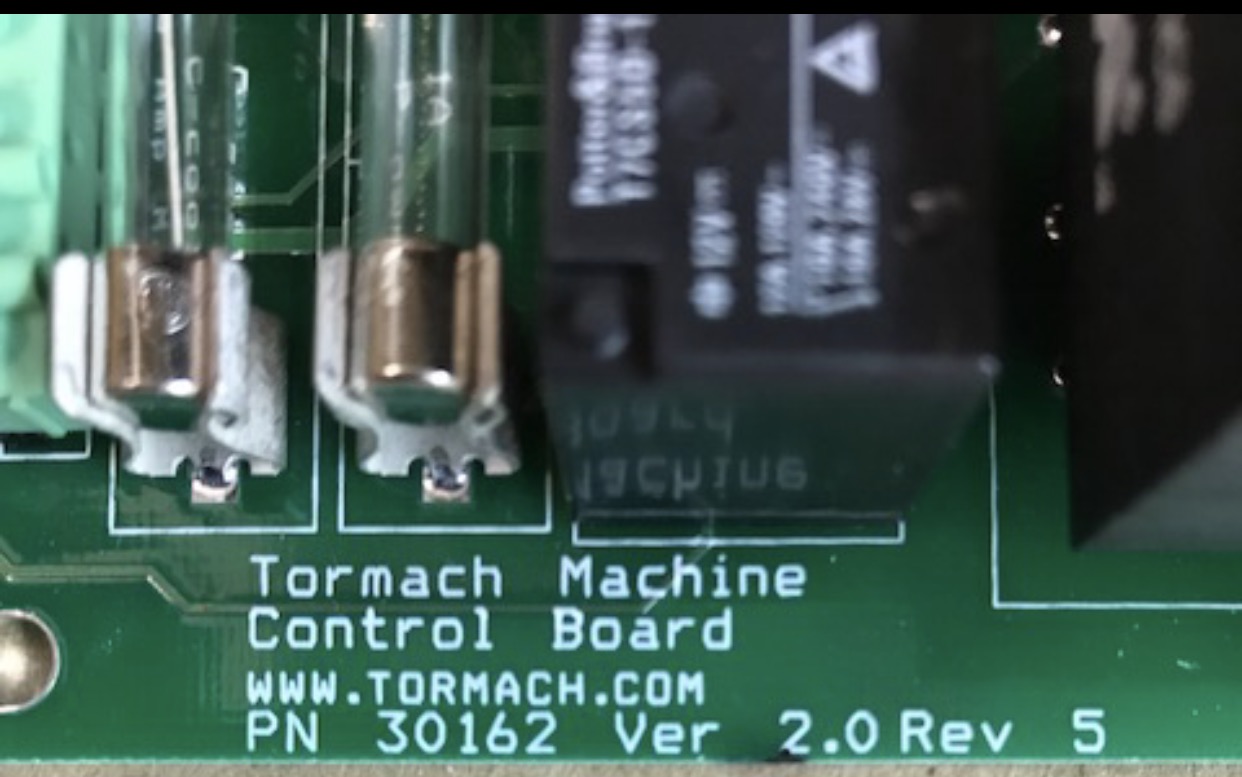

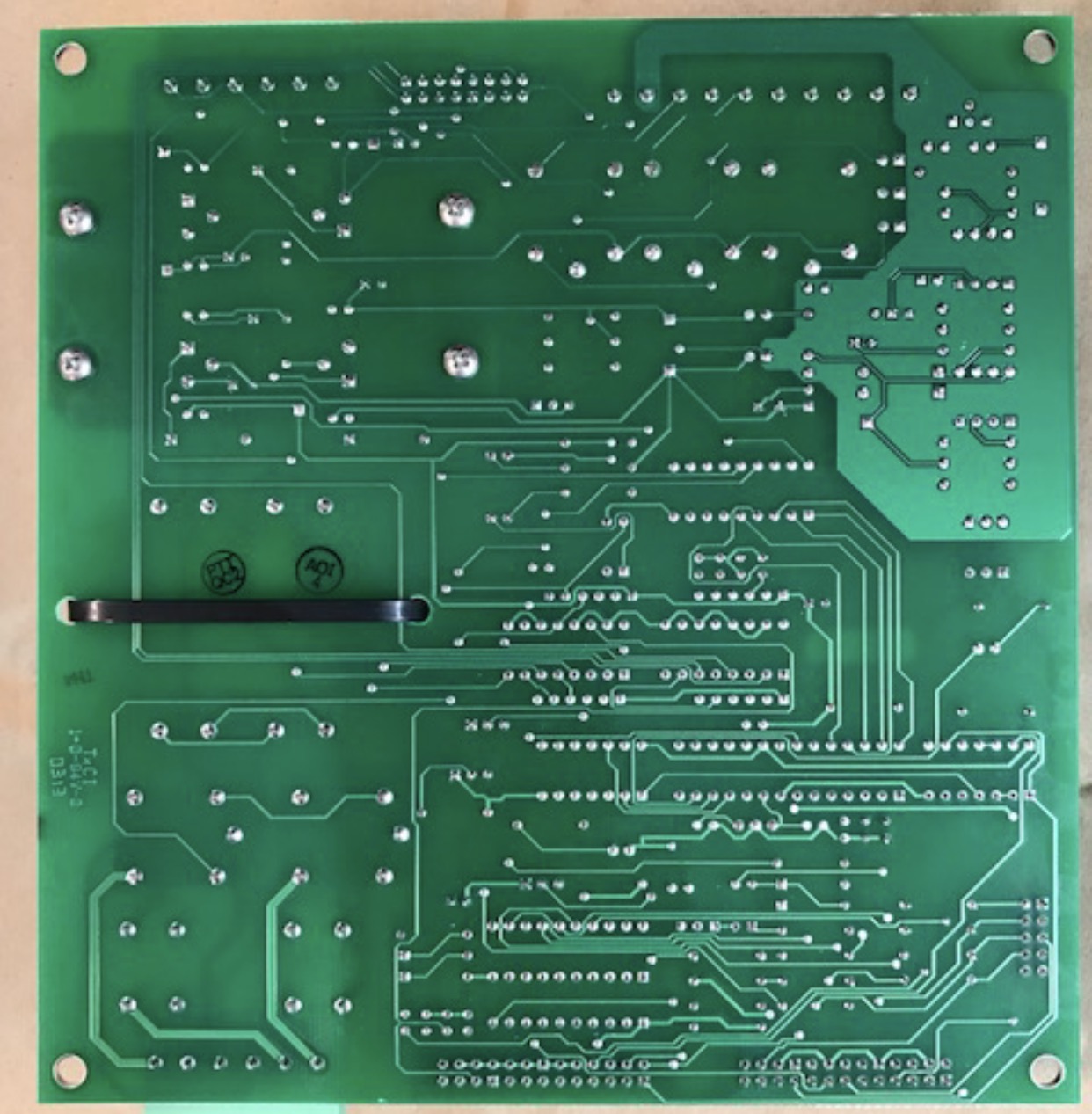

Thanks for the pics.
there is only one component I can't make out but I'm sure it's a 12V regulator and that's the one near TP9. the black rectangular part. Otherwise this is a basic BOB with some code running on the PIC/AVR (i'll bet on a AVR for aurdinio) but could be wrong. code would mainly be handling the Limit switch -> freq conversion and the ATC maybe.
if that's the case you dont' need to reproduce the whole board. just the Limit switch and ATC code.
