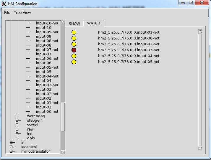

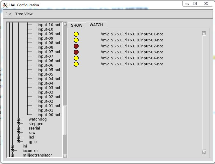

01 Nov 2017 00:20 - 01 Nov 2017 00:27 #101093
by smgvbest
Replied by smgvbest on topic Daughterboard inputs not recognized in HALMETER
Hi
Sorry you haven't heard from me I've been looking at your configs and found the issue
in your hal config you have this line
setp hm2_5i25.0.gpio.010.invert_output 1
GPIO 10 is used by the smart serial interface as seen in the dmesg output.
and in your hal file its noted has
# P3 pin 7 gpio 010
# Z step
so the stepgen is trying to control this pin as is the SS interface
i loaded your config up on my PP machine and had the same issue you do.
I commented out the setp hm2_5i25.0.gpio.010.invert_output 1 and everything started working (though my wiring is different than yours it did respond to all my inputs)
screen shot shows 7i76 input 02 going active
comment out that line in yours and I expect you'll get working.
I had thought it would be either the watchdog or something like this after we ruled out the hardware.
also while it is work, it's best to configure PP hal file completely to help eliminate issues like this.
quick edit to clean up a few thing
btw: if you want halshow working i and another user posted on how to get it working. but as I recall source was needed but i can provide missing files.

01 Nov 2017 17:37 - 01 Nov 2017 17:41 #101140
by Dubmfg
Replied by Dubmfg on topic Daughterboard inputs not recognized in HALMETER
Holy crap! Trying this right now. Will report back shortly.
EDIT: It worked! I have limit switches!!!!!
Now I just have two wiring shorts to deal with, my Z axis only moves upwards (pretty sure thats a ground fault issue) and one of my limits is dead. Awesome!!!! Thanks so much!!!
