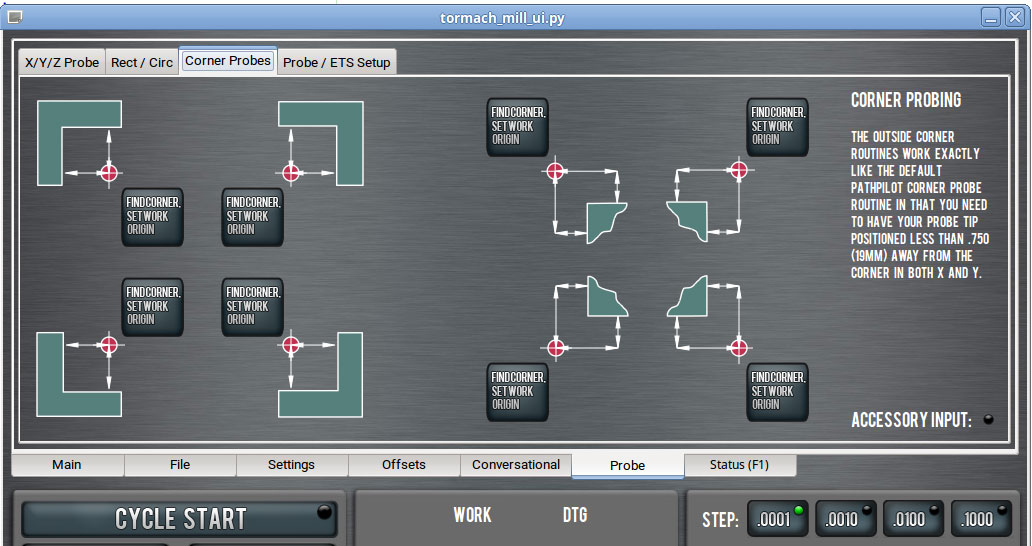

05 Feb 2018 20:27 - 05 Feb 2018 20:29 #105461
by sharmstr
PathPilot 2.x and Glade was created by sharmstr
Last edit: 05 Feb 2018 20:29 by sharmstr.

06 Feb 2018 00:02 #105467
Replied by cmorley on topic PathPilot 2.x and Glade
It would help to know what issues/error messages were when it failed.
Might have to load glade from the terminal to see the error messsage.
(unfortunately GLADE gives TONS of not useful warnings, so the good stuff scolls off the screen...
Chris M
Chris M

06 Feb 2018 00:17 #105471
by smgvbest
Replied by smgvbest on topic PathPilot 2.x and Glade
Try running
~/tmc/scripts/rip-environment.sh
then run glade on the ui file
glade needs the environment setup otherwise there are lots of missing pieces
