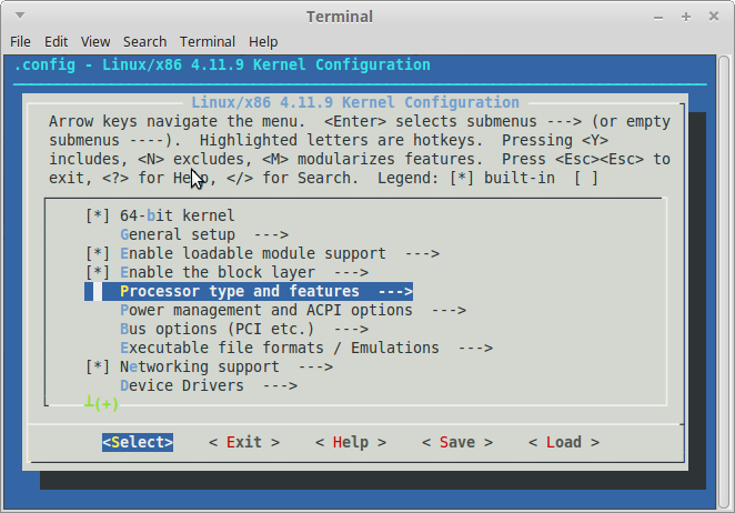

make menuconfigAttachment not found
Make sure 64-bit kernel is checked
Select Processor type and features-->Preemption Model---> Fully Preemptible Kernel (RT)-->back to top menu
Select Power management and ACPI option ---> disable suspend to RAM, Hybernation and CPU frequency scaling --> back to top menu
Select Memory Debugging (found under Kernel hacking)--> Check for stack overflows ( already deselect so dont select this -just check)
Save and exit

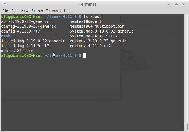

After the kernel is installed check that it is in /boot

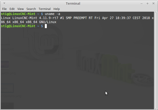

Reboot to enable the new kernel. After it has restarted, run "uname -a" to check that you are running the new kernel.

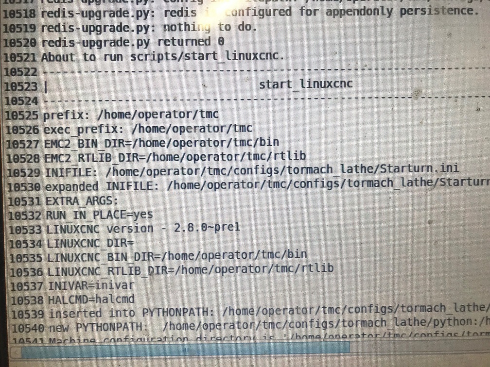

Is Pathpilot _really_ based on an unreleased 2.8 version?
git checkout 2.8
Would get the current 2.8. But it is possible that the 2.8_pre that you used won't have an equivalent in the LinuxCNC repository.
but if it does, I think you can checkout the exact version based on the hash. Do you see a string of hex after the version when LinuxCNC starts?
git checkout 2.8

Please see below the screenshots from the log files at startup.
I originally had a parallel port configuration working under PP2.0 and when I upgraded to PP2.2.4 it stopped working - I had to make a number of hal/ini changes to get it working which in hindsight seems consistent with a version change. I've yet to be brave enough to upgrade to 2.3.6
Cheers

the way I did this was install PP V2 into a virtual machine.
I loaded both PP 2.0.5 source and 2.8.0-pre1 source
installed need dependencies then compiled 2.8.0-pre1, do not install it only compile it from the operator id,
i was then able to pull any libs I needed
compiling pp 2.0.5 from source was fun as the list of prereq was larger as they are not included in the source
hope the 2.8.0-pre1 source helps
