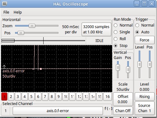

Replied by PCW on topic Joint 0 following error
Right, you wont see any error at 1 inch per division
Try setting the vertical gain so you get say .01" per division

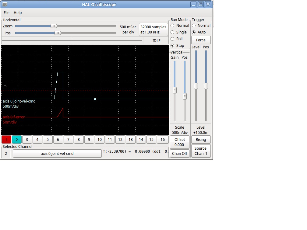

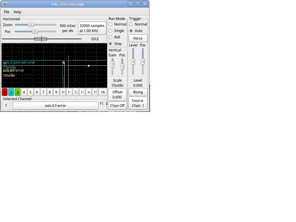

Now reducing the ferror scale to say .01" per division and plotting the velocity at the same time should give a better clue about whats going wrong...

07 Sep 2019 15:20 #144482
Can you scale the velocity and error so the don't go off screen?
Not really possible to see whats going on when you cant see the whole trace

08 Sep 2019 08:33 #144504

I misunderstood your request for scale by some orders of magnitude earlier. Sorry...Can you scale the velocity and error so the don't go off screen?

08 Sep 2019 10:31 #144507
[AXIS_0]
TYPE = LINEAR
MAX_VELOCITY = 1.5 <<<<<<<<<<<<<<<<<<<<<<<<<<<<<<<<<<<<<<<<<<<<<
MAX_ACCELERATION = 15.0
MAX_JOG_VELOCITY_UPS = 1.0
MIN_JOG_VELOCITY_UPS = 0.008333
# 20% higher
STEPGEN_MAX_VEL = 1.2 <<<<<<<<<<<<<<<<<<<<<<<<<<<<<<<<<<<<<<<<<<<
This should be 1.8...
TYPE = LINEAR
# 20% higher

08 Sep 2019 11:14 #144510
by Stigoe
Thanks for the help, all.
BR,
Stig
Replied by Stigoe on topic Joint 0 following error
Well, whaddya know, that nailed it... Thanks![AXIS_0]
