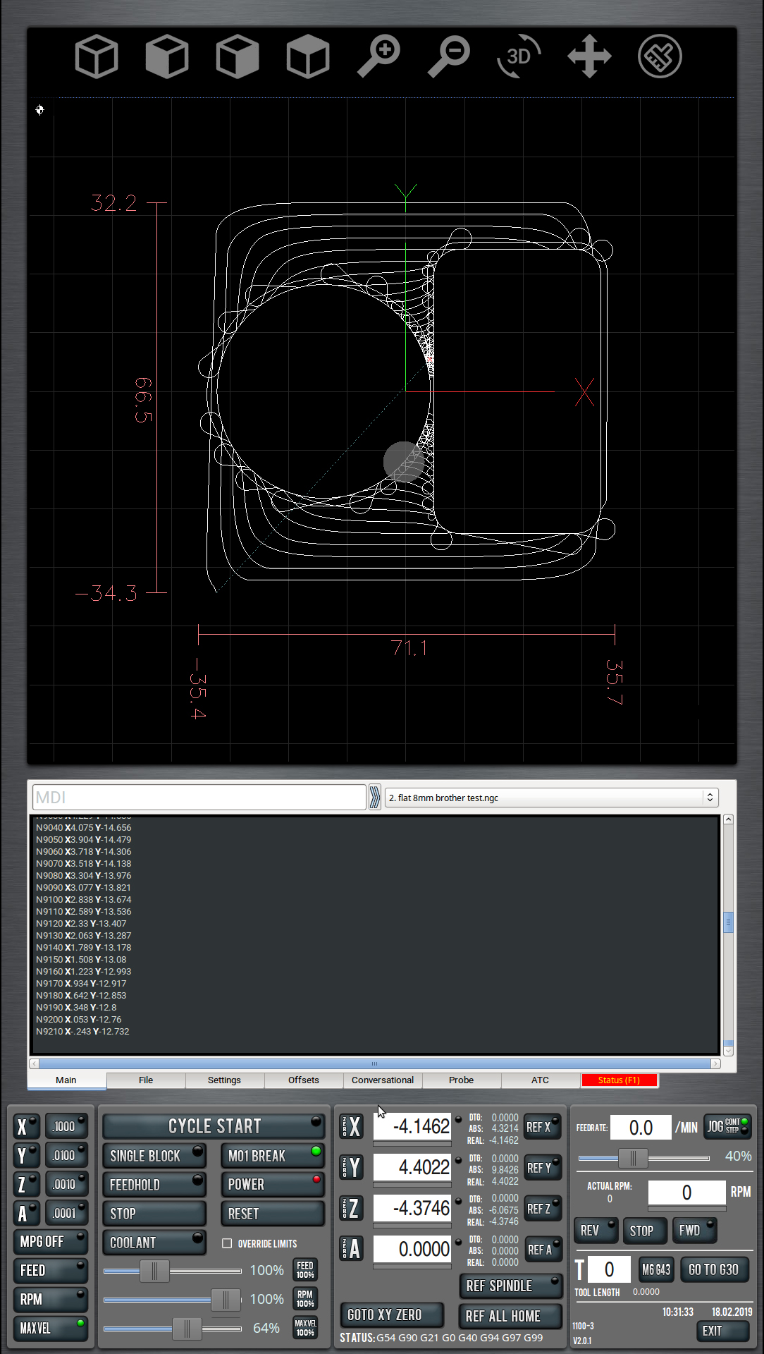

Hey Guys,
In this thread I would like to share with you results of my modifications in PathPilot.
Introduction
Mod is based on PP 2.0.1. Modification was started in 2018 and finished in 2019 thus some data might be outdated (when I am writing this PP 2.6.0 is available). Modified PathPilot is successfully running upgraded Brother TC-225 milling machine.
For those who are using Instagram, you can follow the project here:
instagram.com/my.cnc.brother/
Layout changes
Main obvious change was to put screen to vertical position. I have chosen Iiama FullHD TF2234MC with IPS matrix and capacitive multitouch screen.
My previous machine was driven by Mach3 and I always complain of the size of path preview screen. I always dreamt to have it larger. And there it is... proper size preview screen :-):
User experience
PathPilot in its glory is missing few handy user experience functions.
First of all path preview screen (aka ‘Gremlin’) does not have touchscreen frinedly controls to change the view (projection planes, zoom in, zoom out, rotate move, linear move and to clean the path).
Warning: Spoiler!
Buttons were added at the top of the screen to have it right under my fingerprints.
As you can also see I have enlarged G-code preview window as well.
Control section was modified a little bit as well
Starting from left:
I have added a section for MPG wheel control. You can select axis, step size and also port MPG movement to control FEED, RPM and MAX VEL. If you prefer you can also turn off MPG.
Code control section was completed by POWER button (TC225 specific button) and limits override radio button.
Spindle/tool section was completed only by actual spindle speed display and time and date visible all the time.
Warning: Spoiler!
Position section was modified by adding DTGs, ABS position and Real position (useful for encoder based drives). And… the mod I am most proud of ;-): axis load bars under each axis.
I put there also new useful buttons: Ref All and Ref Spindle button (TC225 specific).
Other Tabs
Only Status tab and ATC tab were changed.
In Status Tab I have implemented some system info (processor speed, RAM usage, etc.) and three counters: system run time, total system run time and total spindle run time. Those values might be useful in regular machine maintenance.
ATC tab mod was most time consuming. It was completely rebuild, according to Brother TC225 ATC (instead of umbrella type in Tormach machines).
Button beep
Due to lack of button press feedback (except visual) I have added button sound beeping. After that operation of the machine is much more convenient.
Cherry on the top :-)
To have machine completed I also changed Linux booting screen and also PathPilot splash screens.
BTW system loading is < 44sec (!):
