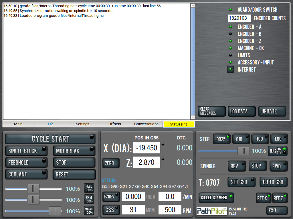

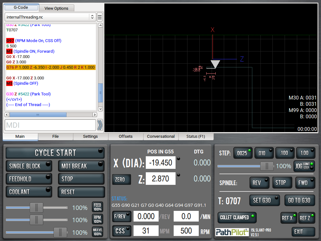

I've tried to enable spindle-at-speed (uncommented the part of the .hal-file) without any change in behavior, except an entry on the Status page about synchronized motion waiting for the spindle, so it seems to be a problem with spindle at speed indication. When I ran the threading program, the speed was 477-479 RPM, while commanded was 500. I tried to set near.0.scale to both 1.05 (5%) and 1.10 (I guess this is 10%), and near.0.difference of both 25 RPM and 50 RPM. Same behavior for both settings.
I also checked motion.spindle-at-speed. Before I uncommented Spindle-at-speed in the .hal-file, I think it was showing true the whole time, both with and without the spindle running. After it was uncommented, it was showing false the whole time. Speed was 500 commanded, 477-479 actual.
The attached screen dumps show the message on the Status tab and where it stops in the program. The threading program was made with the Conversational programming.

If you want to force motion.spindle-at-speed to true you would comment out all lines it appears in your HAL and add this
setp motion.spindle-at-speed true
This way you would actually know that it is true and rule this out. Then you could move on to the next thing.
