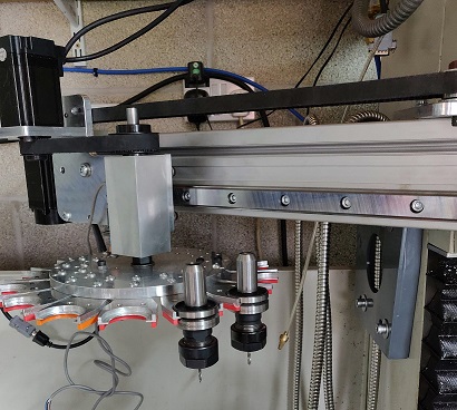

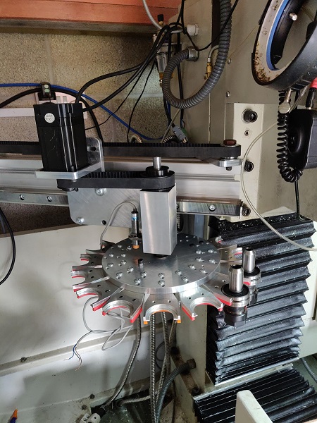

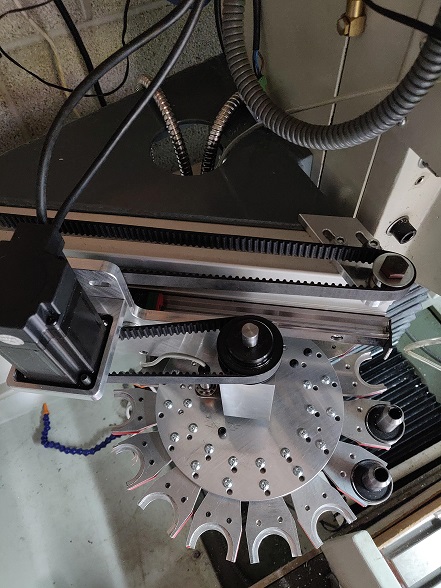

Ok done some more work on the ATC for the Tormach. For the benefit of Tom (he like pics)
I have purchased the V1.1 pyboard and the FT232R I have also got the Tormach rules
Would anybody be will to share the code to get this working
I am not sure if PP will accept 15 tools by default. I believe it will accept 8,10 or 12 tools
The following user(s) said Thank You: tommylight, snowgoer540
- Posts: 22009
- Thank you received: 7491
25 May 2021 22:01 #210275
Replied by tommylight on topic DIY Arduino ATC Pathpilot....
Yes, yes, me like pictures! And videos.
Looks niceeeee !
