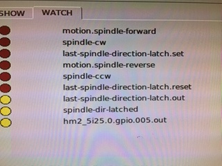

Still on the old flipflop, PathPilot V1 has no functioning halcompile, tried many ways but tripped up every time
What I have is (relevant part):

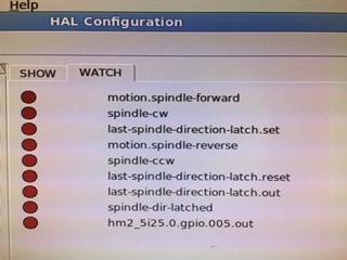

After starting PP what I expected to see was:
1) last-spindle-direction-latch.out (flipflop out) HI
2) spindle-dir-latched HI
3) hm2_5i25.0.gpio.005.out HI
but they are all LO, the flipflop is not set by the setp line
Once running it works as it should.

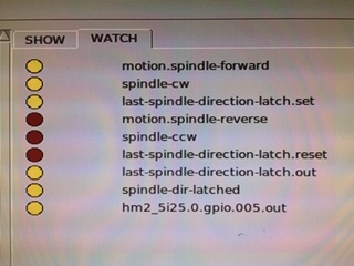

FWD RUN:
STOP after FWD RUN:

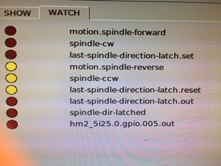

REV RUN:
The STOP after FWD RUN is what I was expecting initial state to be.
What am I missing?
Ken

- Posts: 19902
15 Apr 2021 20:50 #206043
Replied by andypugh on topic Spindle direction signal when stopped
You could try using the flip-flop "set" input, but would have to un-set it again somehow.
