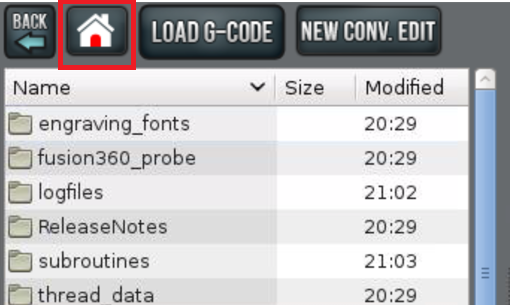

I have only just been introduced to the whole Linux Pathpilot thing so I can't say that I know where to look when it comes to remapping buttons in the UI. I have searched around the files on the Linux machine trying to familiarize myself with how the files are setup. I have even messed around in the .glade file found in \python\images\tormach_mil_ui.glade but it doesn't seem to have the Home button in the editor. I'm to find a way to modify the PathPilot UI in a way so that the home button under the file tab is remapped to take you to a specific folder rather than the main root folder if that makes sense.

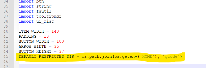

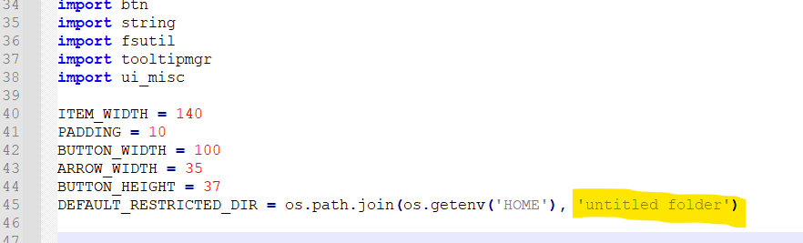

Thanks for responding I'm glad to know that "Tormach_file_util.py" is probably the correct area to look seeing that word find sees many mentions of the home button in the file "Tormach_file_util.py". even so I can't seem to understand how you change the button mapping so that the home button takes you to a specific folder of your choosing rather than the default folder "gcode".
I feel like this line is what needs to be changed DEFAULT_RESTRICTED_DIR = os.path.join(os.getenv('HOME'), 'gcode') and change it to DEFAULT_RESTRICTED_DIR = os.path.join(os.getenv('HOME'), 'untitled folder') ("untitled folder" is the folder is a generic name we will use it for explanation purposes) would I be correct? if so I have changed this and saved the file after the changes were made but when I tried this in Pathpilot the home button seemed to be still mapped the default 'gcode' file.
