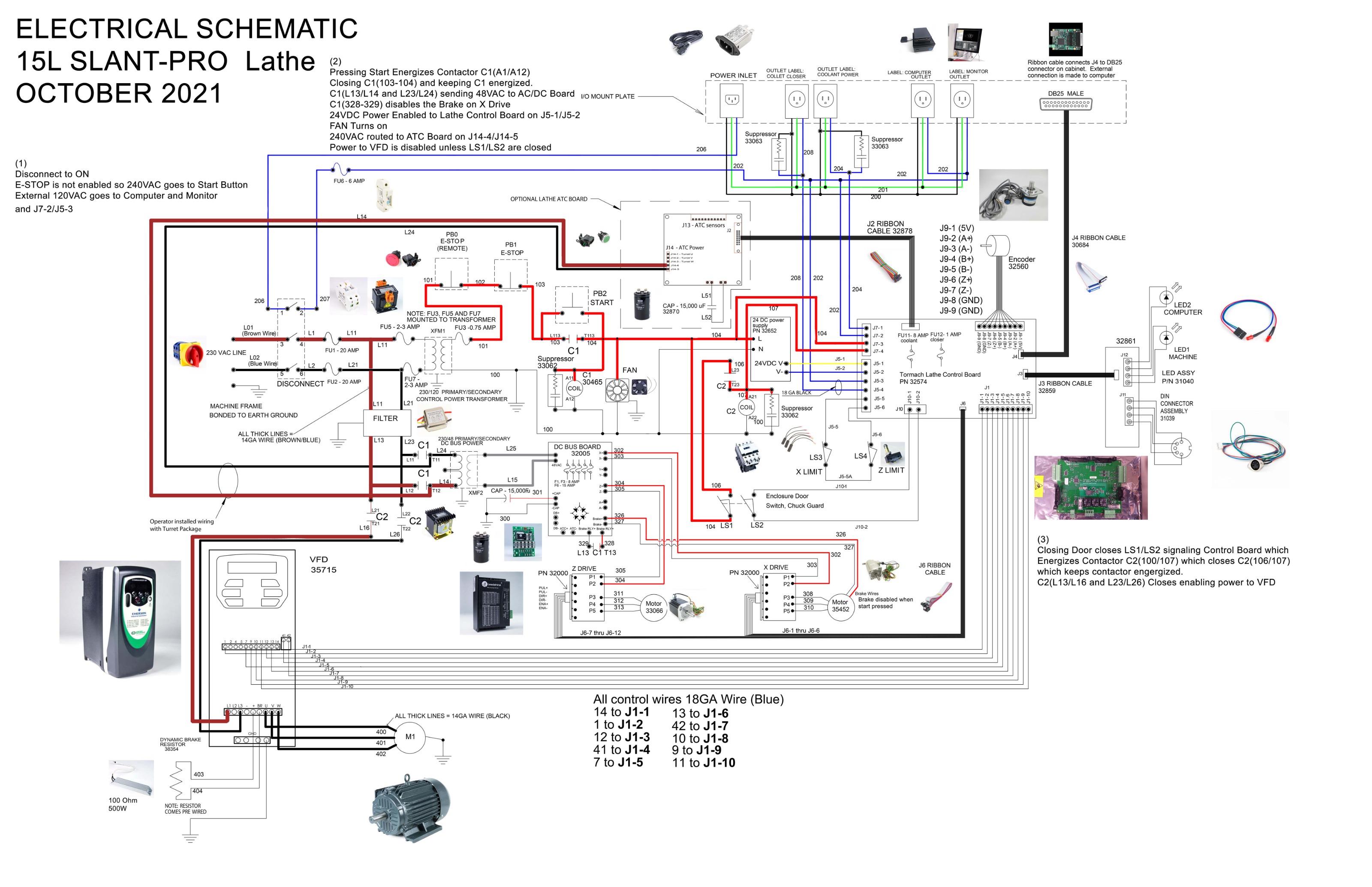

I've been under the weather for some time and for what ever reason I took and color coded the Electrical diagram and cleaned it up a bit plus added notes for the power up process used on the lathe.
Sharing here if anyone is interested.
I thought about adding the control board pin out (estimated) and other helpful items if there is interest
does anyone find this useful?
the full size image is too large to upload here if there's interest in it I can make it available online and can post the link here

Of course it's useful!
You don't often come across diagrams that are easy enough for a novice to follow, but are still professional. Trying to follow a multi-page ladder or circuit diagram is miserable the first few (hundred) times.
And the component pictures next to the symbols are invaluable for new folks, too.
Thank you.

Definitely useful. Thanks for sharing!

Can you tell my what software you used to make that diagram? I need that exactly!

I just converted the drawing from the manual to a png file and edited in photoshop.
Not what you’d expect

Thanks for letting me know! I need to make some wiring schematics very similar (though less complex) to that and I'm not liking any of the free or cheap software I'm finding. Regardless, thanks for the help.
