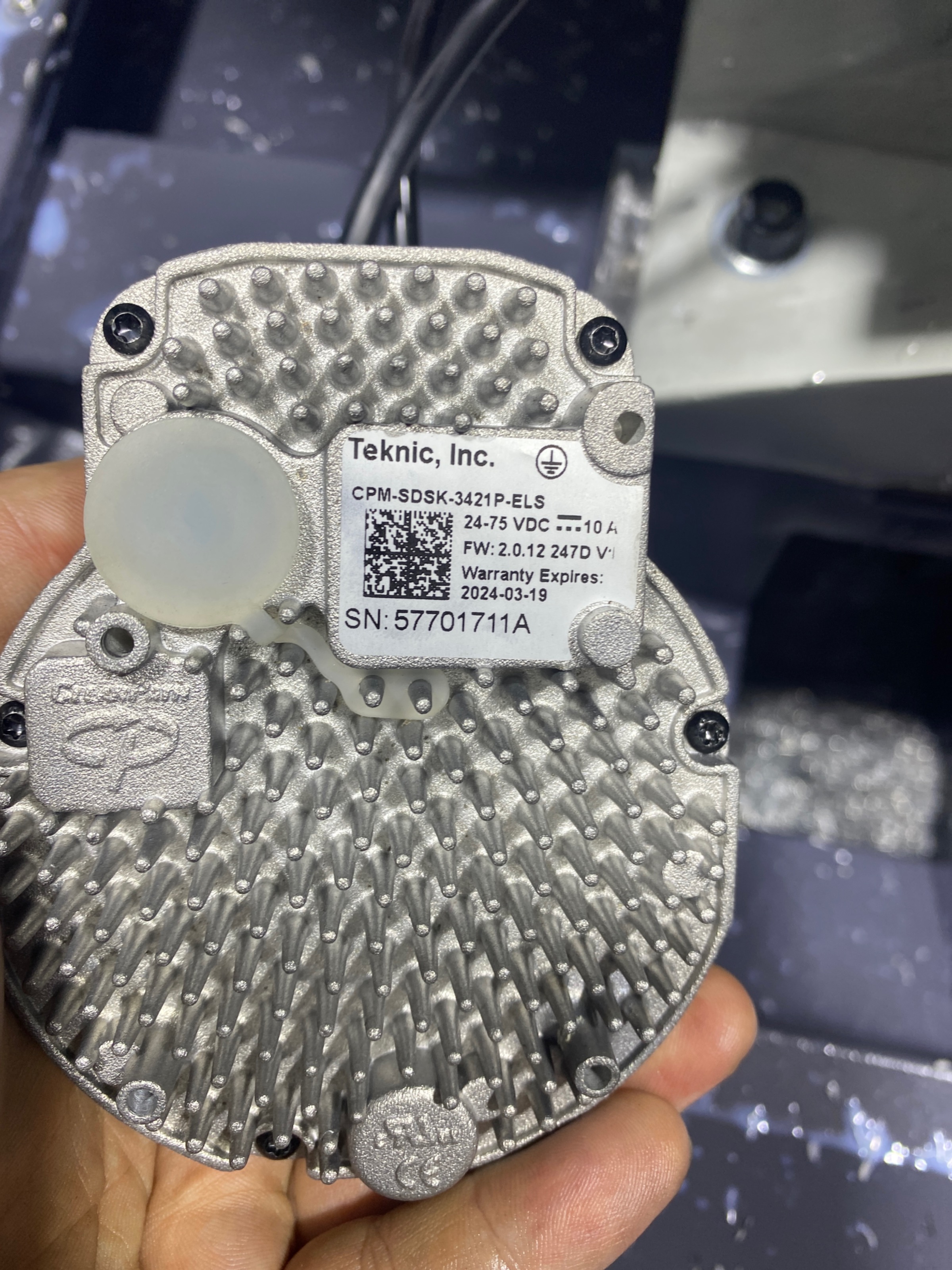

Here’s the X motor (pic)
im not sure how to access the background stuff like HAL in pathpilot.

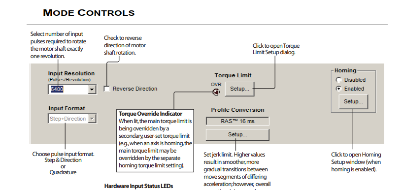

The -ELS suffix indicates the hi-res encoder (6400cpr) and shaft seal options. So I don't think the issue is caused by encoder native resolution being too coarse.
OP - if you can get a windows computer you can D/L Teknic's free tuning software. Be a good idea to check - not necessarily change - the settings on the servo. That may help while chasing down this issue... specificaly the Input Resolution. That setting, coupled with the ballscrew pitch should identify the mechanical capability and minimum resolution of the 1100MX.
This info isn't going to fix anything on its own, but may help while running down other possibilities.

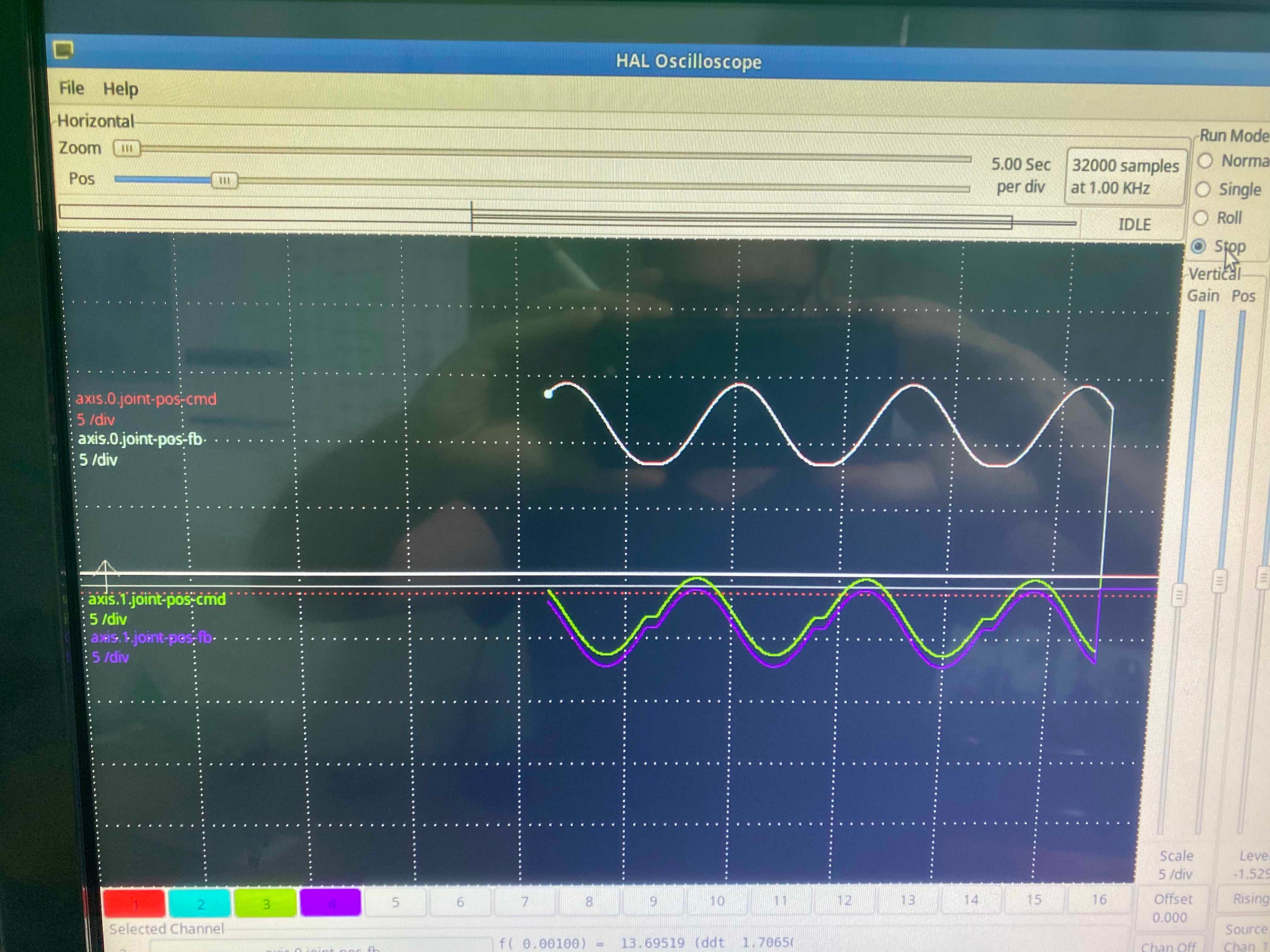

Gentlemen,I also didn't have a chance to check this more over the weekend, had to work around the issue and produce some rush parts for someone, then spent Sunday tearing it back down and rechecking ballscrew preload and backlash - Both of these are good. Stick slip doesn't seem to be the issue.I still need to see if I can find a window's PC so that I can pole the clear path settings and see what's going on there - Though Tormach did mention that even checking the motor settings can be "dangerous" as they have seen setting get wiped/replaced in the past in doing so - So I'm a little reluctant at this stage.I did dig into the halscope as suggested, and ran some circles while monitoring both the commanded and feedback channels of axis 0 and axis 1 - Attached is the screen shot. I'm not zoomed in very far, but it looks to me a lot like axis 1 is wayyyyyy behind whereas you can't even see the difference on axis0 as they are overlapped so well. I'm assuming this does probably mean there's some tuning to be done on the clear paths - uncomfortable.Not sure which smoothing mode I was running on the parts I provided pictures of earlier - I can double check a bit later.Really appreciate all the help and suggestions so far - Great community here.-Chris

They are clean circles - It's also doing it on straight slanted surfaces.
Only surfaces that are perfectly in-line with X and Y appear to be perfectly smooth.
Will get back on the smoothing as I'm not 100% sure on this one.

It is a quick overview of using their tuning software with Clearpath. Something I think would be interesting would be comparing some of their scope readings with those from halscope where possible. (To see how the position commands from Linuxcnc compare with the commands received by the drive.)
