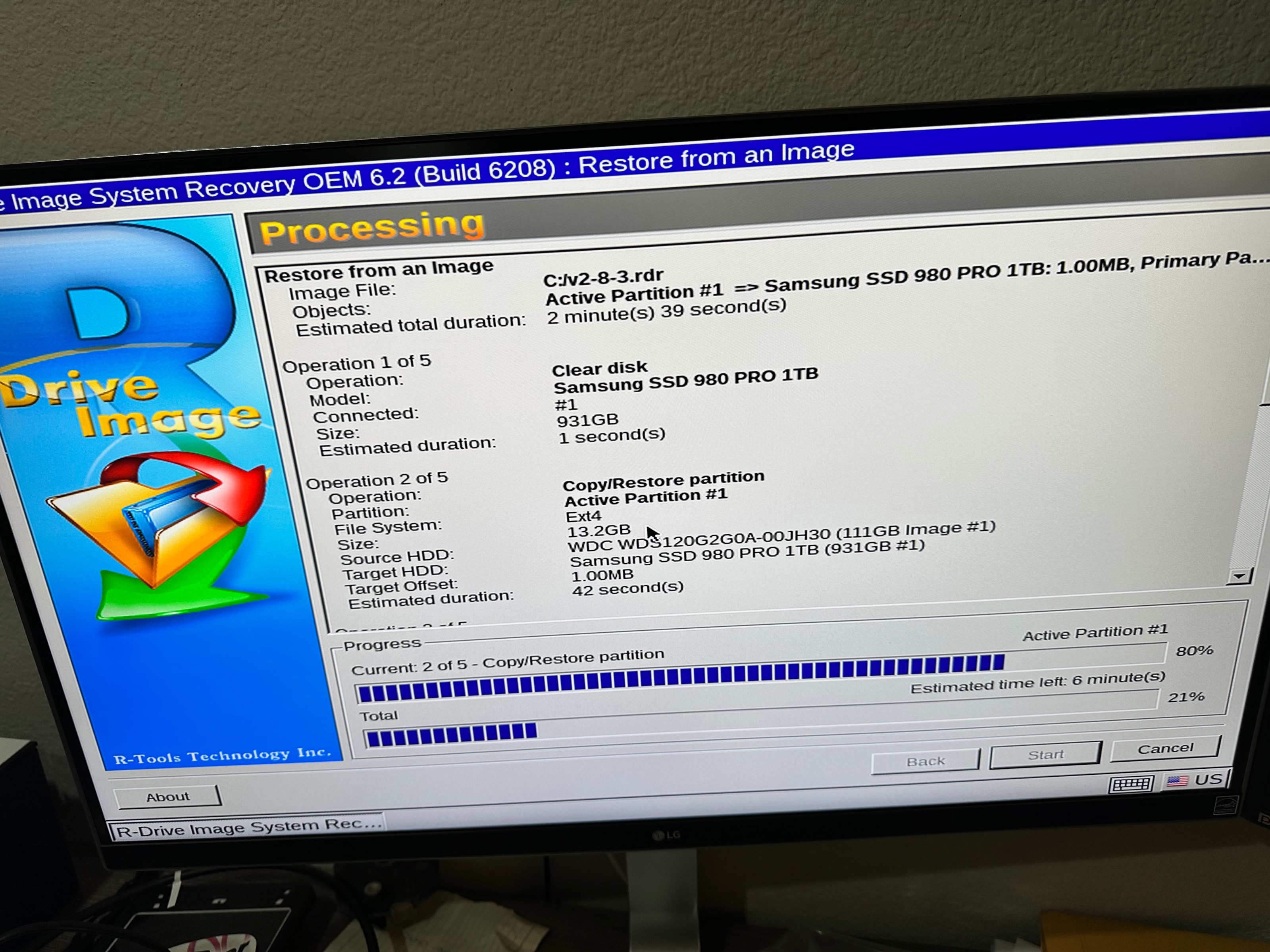

Hi everyone,
I'm trying to do a fresh install of PathPilot on an Intel NUC, which I'm sure will have it's own challenges but for now I want to make sure I'm understanding what the recovery USB is for.
I should be able to do a full/fresh install from the recovery USB onto a new SSD, correct?
I can boot to the USB just fine, it goes through a few steps, recognizes the SSD as the correct destination drive, reformats it, and finishes with no errors.

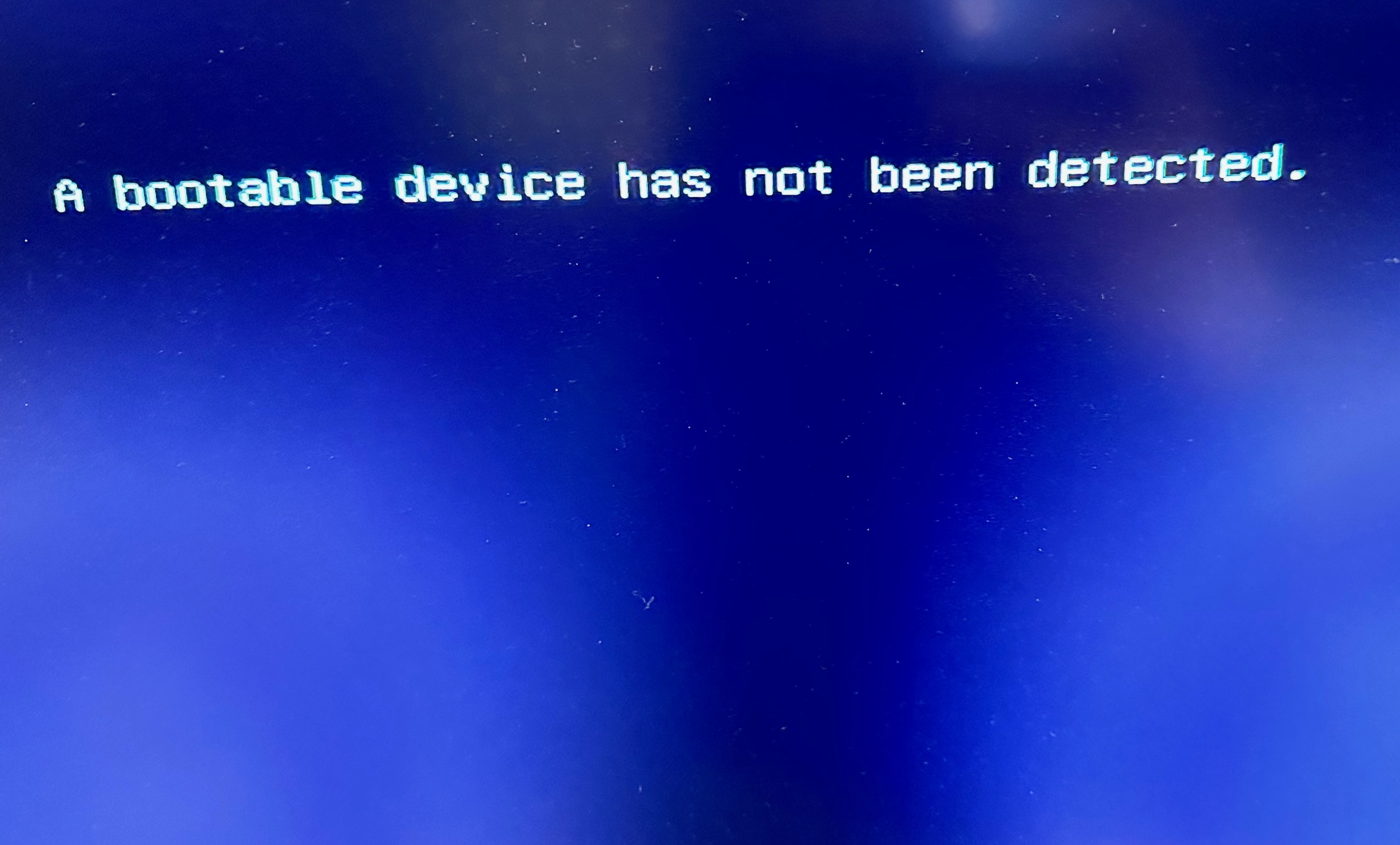

However, when I reboot, it can't boot to the SSD and I just get an error on screen
'A bootable device has not been detected'
The USB should do a full install right??

Yes it should,
But make sure the PC is set for a UEFI boot not master boot record.

Ok I made some great progress, but not in a way I wanted.
Looks like UEFI boot is the issue and it will not work with it. Do you have it working with UEFI?
I installed it in VMware and had the exact same result where it appeared to install OK but then wouldn't recognize a bootable drive.
When I went into the VM settings and changed the VM BIOS from UEFI to BIOS, it immediately booted up to the Tormach screen.
this specific Intel NUC will not support Legacy, non UEFI bios.

I've got this resolved somewhat for now but not with UEFI.
As I mentioned, Intel no longer supports Legacy BIOS including the NUC 11. However their previous gen, the NUC 10, it was still supported.
I installed it on a NUC 10 with the same m.2 NVME drive, enabled legacy (disabled UEFI) and it installed and booted up with no issues at all.
I'd still like to get it working with UEFI someday, especially since it is supported by linux Mint.
So if anyone comes across this and is looking to do the same, I can say it installed with absolutely no issues on a NUC 10 from the PathPilot recovery USB, simply have to disable UEFI. I also downloaded and updated to the latest PathPilot 2.9.2 with no issues as well.
