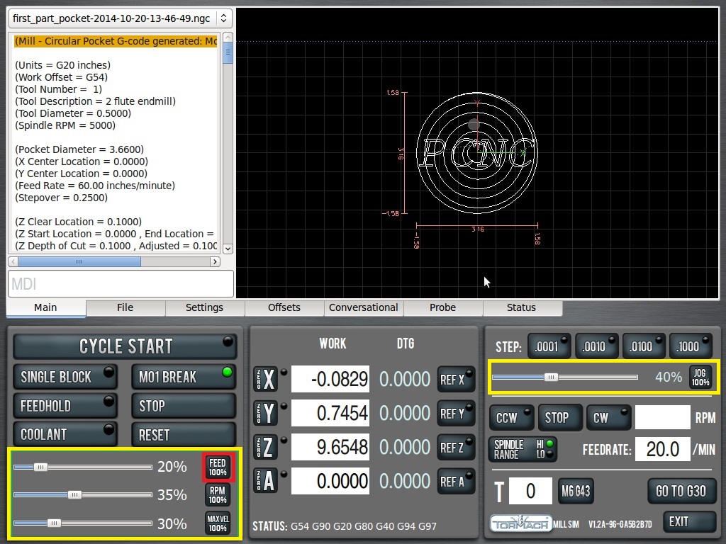

Three really useful tweaks for Pathpilot, anyone know how to do it?
You see in the attachment, faders highlighted in Yellow.
Some way to set them to 100% on the speeds and 1% jog whenever I am running a tapping job with some Gcode or system command.
Also another, if using the electronic edge finder in pathpilot, the feedrate is taken according to the last operation that took place.
Some way to set the feedrate whenever a "find edge button" is pressed. So that it is always the same regardless of other factors/settings..
Also, to stop the screen jumping to the error screen whenever an error happens.
