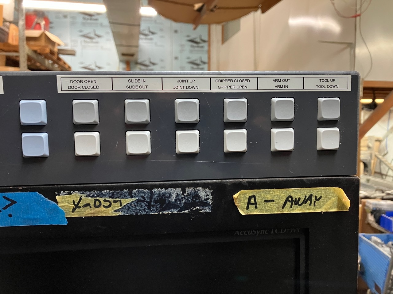

Thank You very much for the help. NOW on with the show. Here is a Picture of the addon keypad. It has a total of 26 keys You help me save 6 switch positions. Instead of having to use 2 switchs to open/cose we now only need 1 switch and the shift key from the keyboard.
(;-) TP
