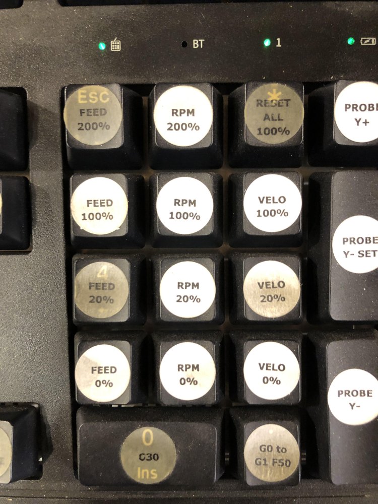

2 years 3 months ago - 2 years 3 months ago #304850 by Dorro1971
this might work..in tmc/python/tormach_lathe_ui.py or tormach_mill_ui.py
look for this phrase..
# Escape used to stop certain UI tasks.
if kv == gtk.keysyms.Escape:
self.error_handler.log("ESC key - queueing stop event")
self.enqueue_button_press_release(self.button_list)
self.tool_descript_entry.shutdown_view() # if active terminates the tool description overlay
self.profile_renderer.update() # if active terminates a zoom view on the profile render
tooltipmgr.TTMgr().on_esc_key() # if active end the current tooltip.
return True
#w key on keyboard
if kv == gtk.keysyms.w:
self.sliders.set_slider_value(100)
return True
i use this addition for a jog encoder and spindle,feedrate,maxvel panel encoders...this version does need variables declaring earlier in the program but you might get the idea...

panel encoder send a keypress for each indent ...
sorry for pasting code but i can't remember how to wrap it!...
Dorro
