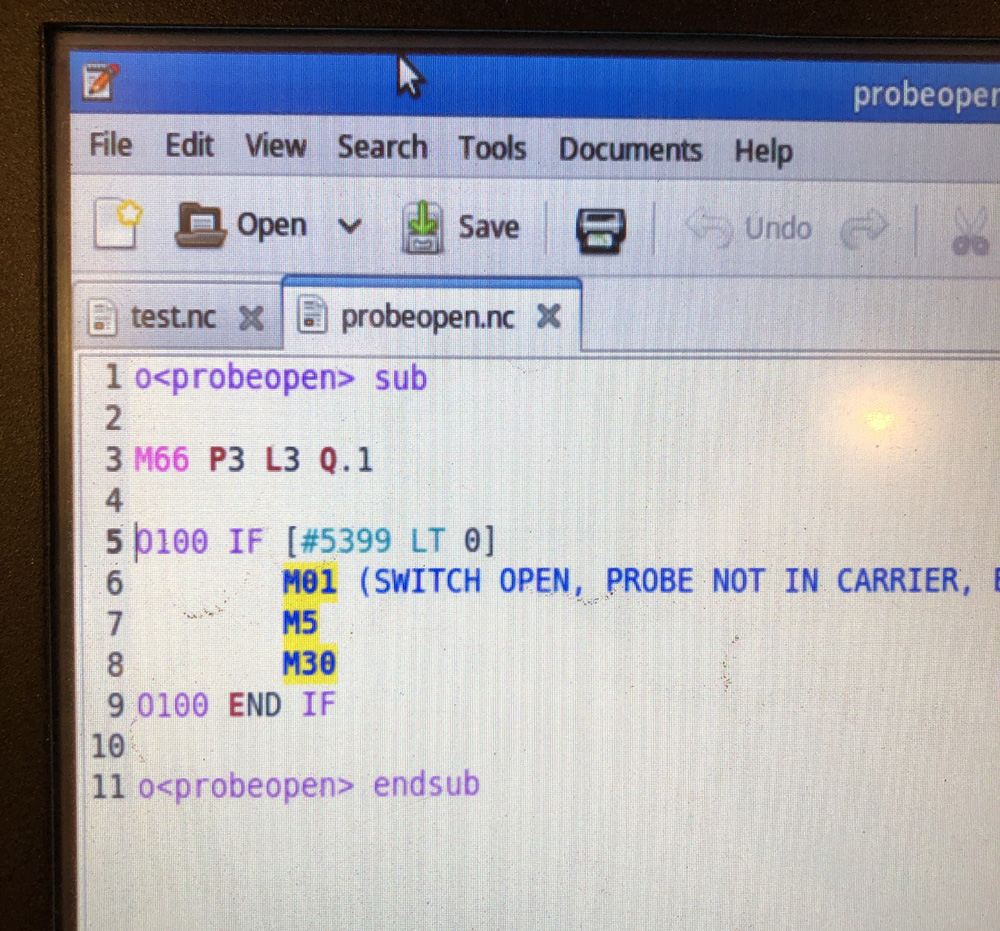

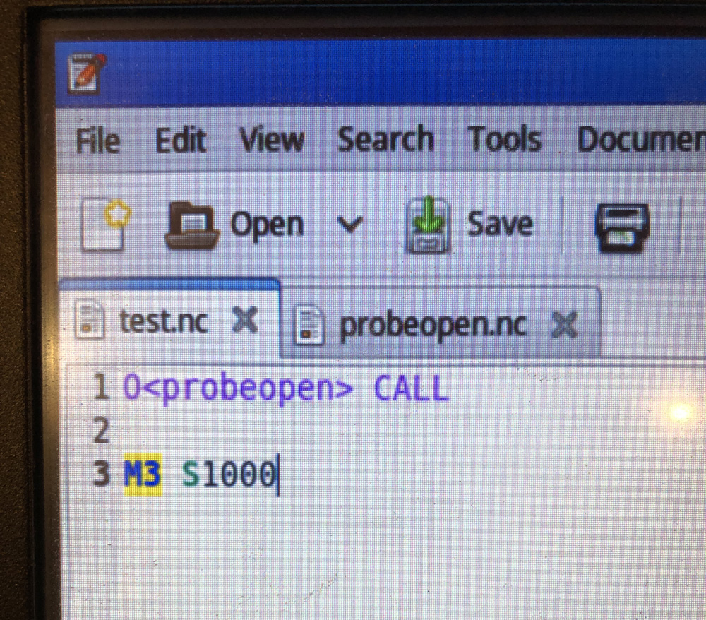

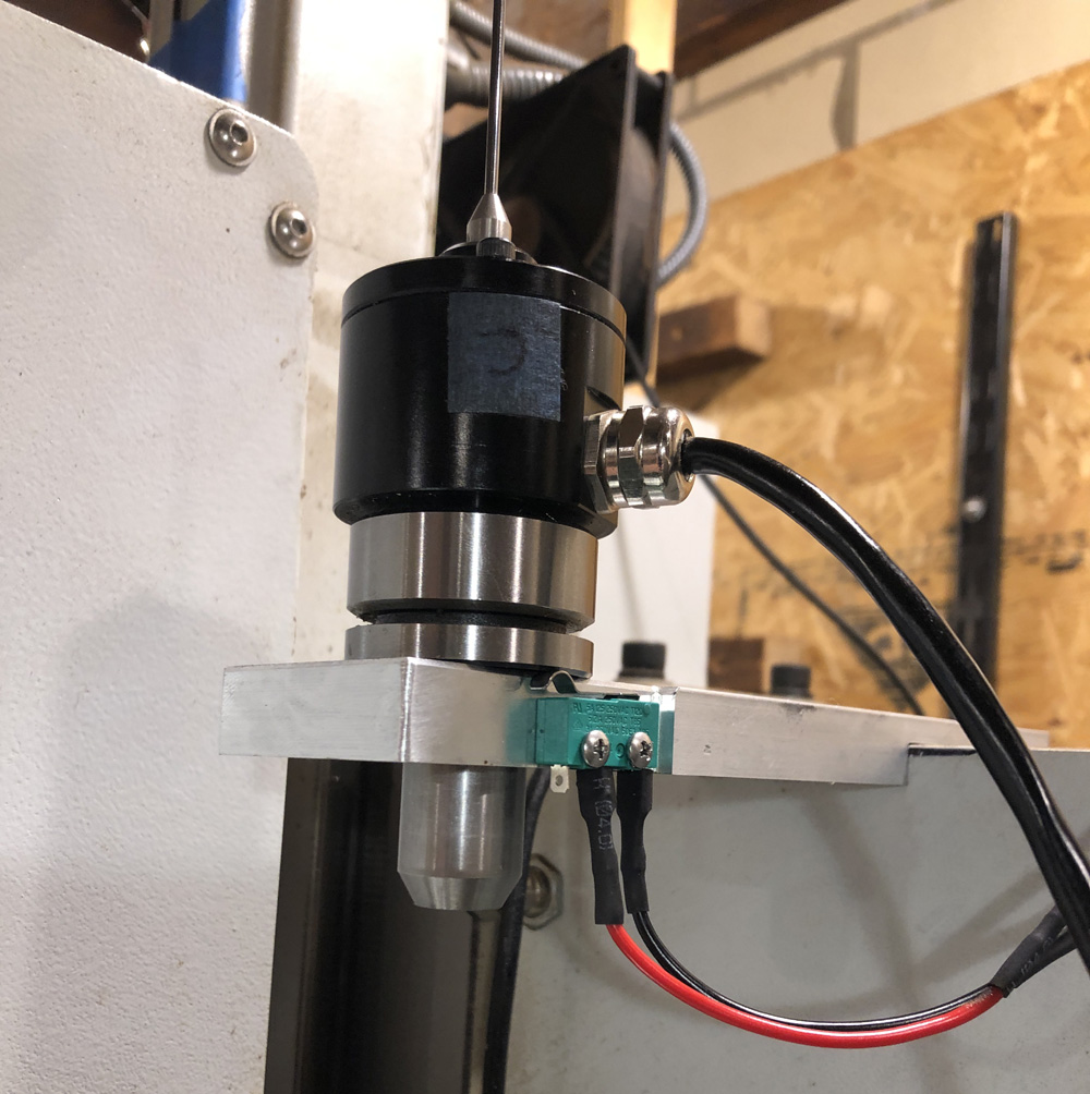

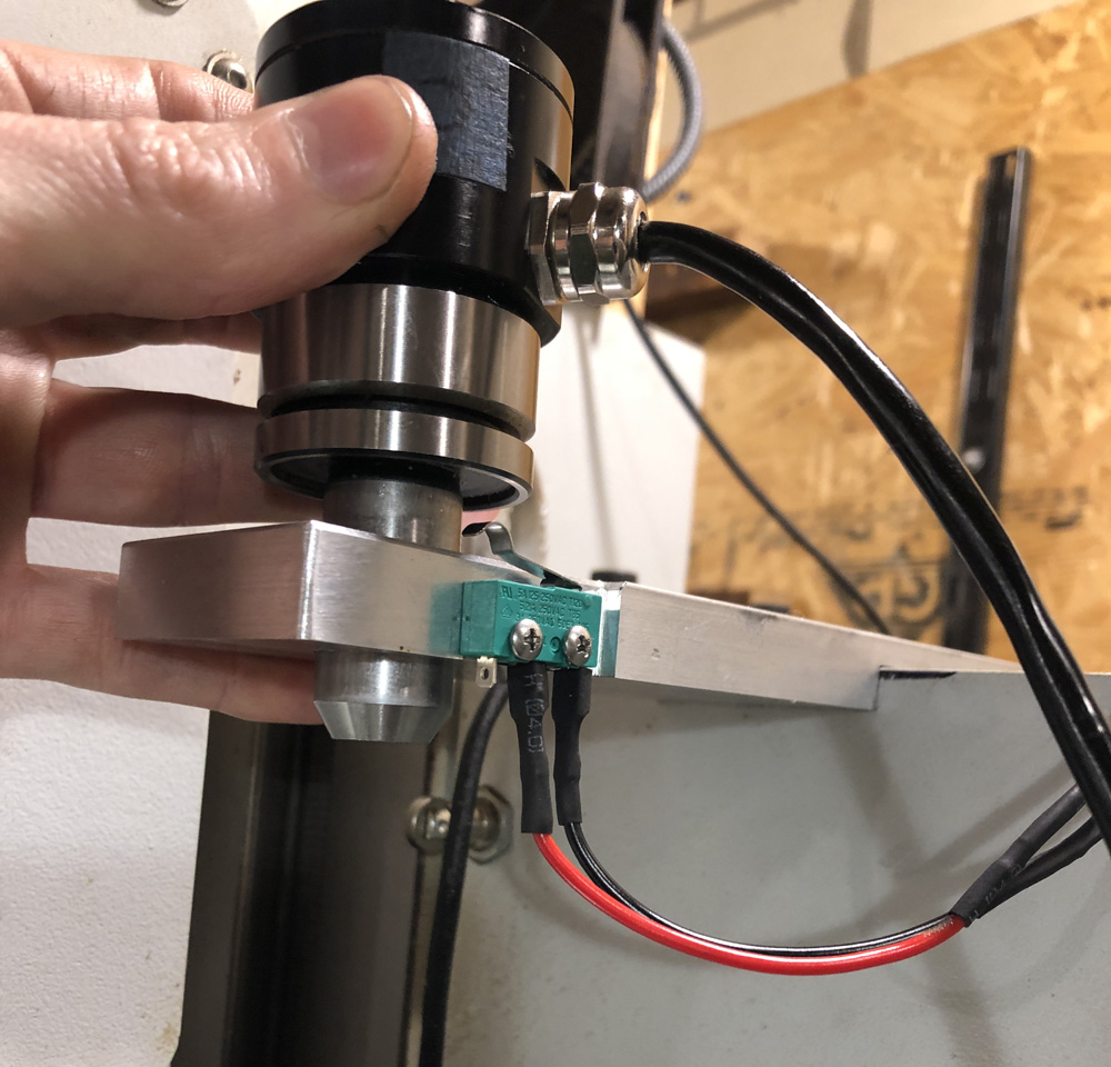

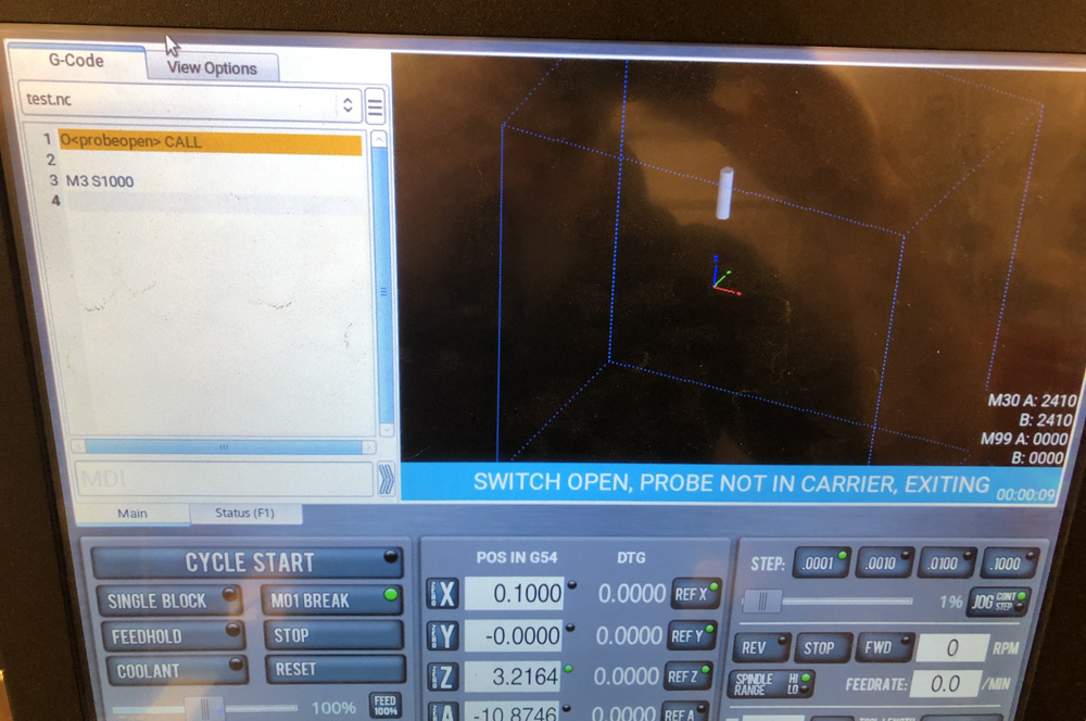

I'm trying to implement momentary switch-based probe protection. If the probe isn't in its carrier, the spindle won't spin.
I have it working with a subroutine, but this requires a CALL in each program and doesn't protect against manual MDI entry.
Anyone know how to monitor the IO board inputs continuously?
O<probeopen> CALLĀ
M3 S1000o<probeopen> sub
M66 P3 L3 Q.1
O100 IF [#5399 LT 0]
M01 (SWITCH OPEN, PROBE NOT IN CARRIER, EXITING)
M5
M30
O100 END IF
o<probeopen> endsub

Just the spindle?
An and2 component wired before spindle.on should do just fine.
That is all in hal.
So the spindle runs only if the probe trigger is closed and spindle is commnded from hal.
That is all in hal.
