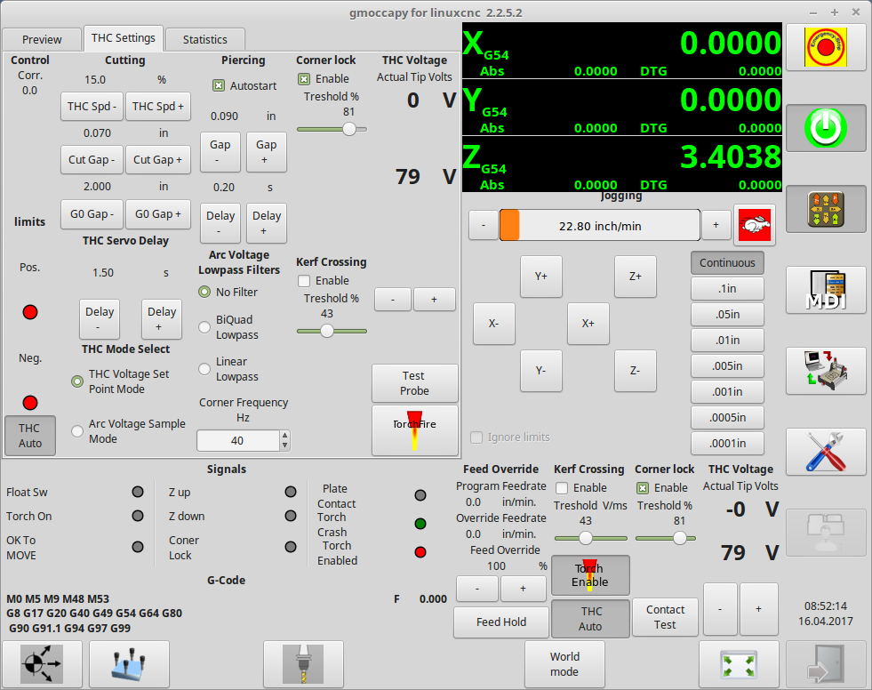

Hello
Here is quick screen shot showing my user interface for all the plasma related settings. Some will go away or be modified in the future as find what works well.

Been following this, looks nice so far. I do not have the THCAD, so i use the config i mentioned here several times that i modified, works extremely well vith simple THC's.
I also have two of my own design so i can program them to send any type of signal to the 5 outputs, so i was thinking that i should use those to send the pulses back to the computer, same as THCAD does, as to be able to use this config.
I am pressed for time, so unfortunately i can not help much regarding this.
Great job.

John, your screen is very comprehensive and makes mine quite modest by comparison..

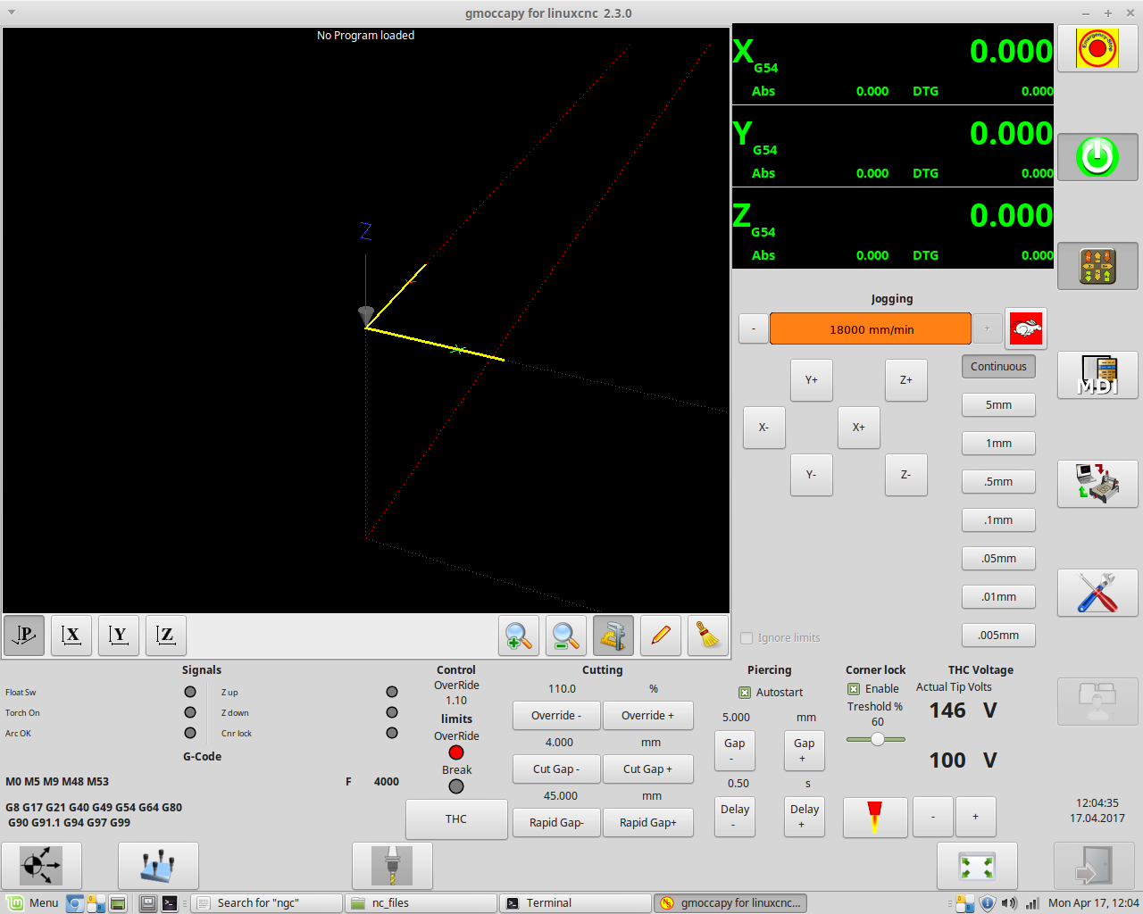

I tried using glade to edit the GUI screens and while I could open plasma.glade, it broke it when I saved it. Anybody got any ideas on what might cause this?
I've now got all of the main items hooked up with the exception of piercing parameters, cut height and rapid height. As these are currently set in gcode, I have not bothered with them for now.
I did not think THC speed was relevant anymore so I've repurposed the buttons for feed override.
Cnr Lock LED lights up when the velocity is below the eoffset_pid minimum velocity,
There is also an LED indicator that is turned on if a feed override is programmed as well as one for torch breakaway.
I'll also have a look at the kerf crossing as it looks simple enough and will post it up as I've done with the other components I've written.
