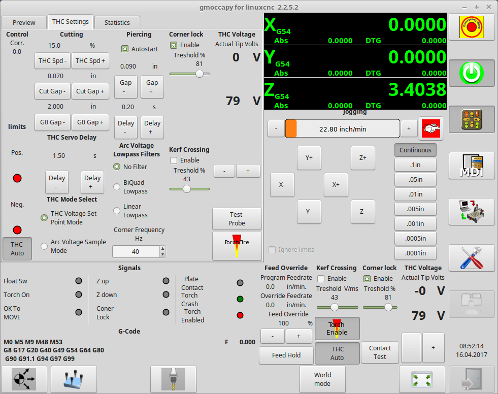

Hello
I have been working getting cutting settings from gcode part files and into a working plasma setup that uses the new external offsets code. This is not new ground, CandCNC has this for their old Mach 3 systems and their new Command CNC systems. I couldn't find a specification document for this so I reverse engineered it from Sheetcam post processors that incorporate it and vague manual pages. There are probably errors in my interpretation of what is happening. I choose this route because there are tried and tested Sheetcam posts that use it. This uses M67 or M68 E0 Qxxxx to send over the command and motion.analog-out-0 to get it from the gcode interpreter. I will post this as series of code snippets because my files are large and very messy which will lead to much confusion.
I have tested this using MDI commands and monitoring the results on my GUI and halshow.
So to start things off we need to get the command value from the gcode interpreter for use by other parts, this is in one of my HAL files:Now most of this is to modify working system values that are displayed in my GUI (Gmoccappy). To do this I used one of the Python files that is linked to one of Glade files for a tab. First we need some HAL pins to handle the io from the HAL:
Then we need to link to that pin and link it to a function:Finally we have the function:
Now this much will get value changed on your GUI and in controls if it already has the adjustments, buttons or labels in place (notice no editing of the Glade file required to add this).
Now this still leaves the THC height hold function as a user space item, I will post the the modifications to a component and the HAL connections for this in my next post.
Oh by the way I am NOT a software professional and I am sure there are errors that I haven't found yet in these files.

Back now with the real time part of the gcode command decoding. I choose to modify my Kerf-Crossing.comp to add the the real time decoding. This uses the hold-request input pin from eoffset_pid component to effect the height hold. This will mostly look like a repeat of part of the Python code to support the Glade tab from the user space controls.
First some HAL connections to get every thing connected:and
Now the additions to the Kerf_Crossing.comp:
That is all that is required.
John

Now I've absorbed the links you published, I have to say I'm blown away with what you've put together. Not only have you solved how to set a variable from within the GUI and gcode, you have sketched out a complete framework that will allow LinuxCNC to be used to build commercial quality plasma control by spending just $70 on hardware for the Mesa THCAD and $140 or so for Sheetcam. that combined with an open source motion motion controller, that is a truly disruptive price point!
For those that are following along and have not looked at Sheetcam, it runs on both Linux and Windows and the free demo mode has enough features to really understand how it works and test your config.
Somehow we need to all work together to package this all up into a reasonably easy to deploy package.
But I have 1 question to get back on topic.
Where you define this pin in your GUI:Is there a corresponding field in your glade file or is it just fully contained in the python file?

That is a HAL pin created in the Python file, it is in second of the code snippets in my post. The "Plasma_Tab" is the name of the Python file and the "Command-From-File" is the name of the pin in the Python file. This is part of the fun you have when you have multiple tabs. The main HAL file can't see these pins until they are connected to signals, that is why I have so many files. Each tab takes a Glade file for the screen, a Python file to connect to the screen and do stuff with the data if you don't exclusively use HAL widgets and a HAL file to connect the HAL widgets and pins created in the Python file to the outside world (HAL). It took me a long time to figure this all out as all the tuts only showed part of the process at a time. I have been told that you don't need all the files for each tab but that is how I got it to work.
John
