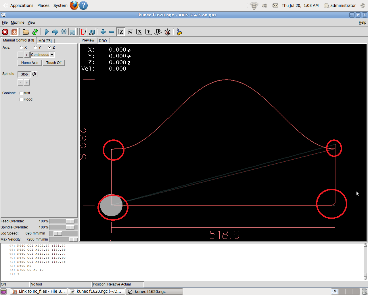

Hello, i have problem with the new version of linuxCnc !!! I use the program for plasma cutter.At high speeds (4000mm / min) curvature is obtained at the edges of the details. I used G64P01 and еxecutes the curves as small segments and stops at each point. Please help !!!!

What version of LinuxCNC? Versions > 2.6 Have a quite capable trajectory planner
that can follow paths and maintain speed at corners as well as your machine acceleration limits allow
G64P01 sets the path following limit to 1 mm which is quite large
so this would definitely result in unwanted path deviation at sharp curves
I dont see how you would stop at ends of segments unless you have a G61 in your file

A bug is possible but If you have rounded corners its much more likely that you don't have G64 P Q set properly in your GCode

Could you post a copy of the offending g-code program?

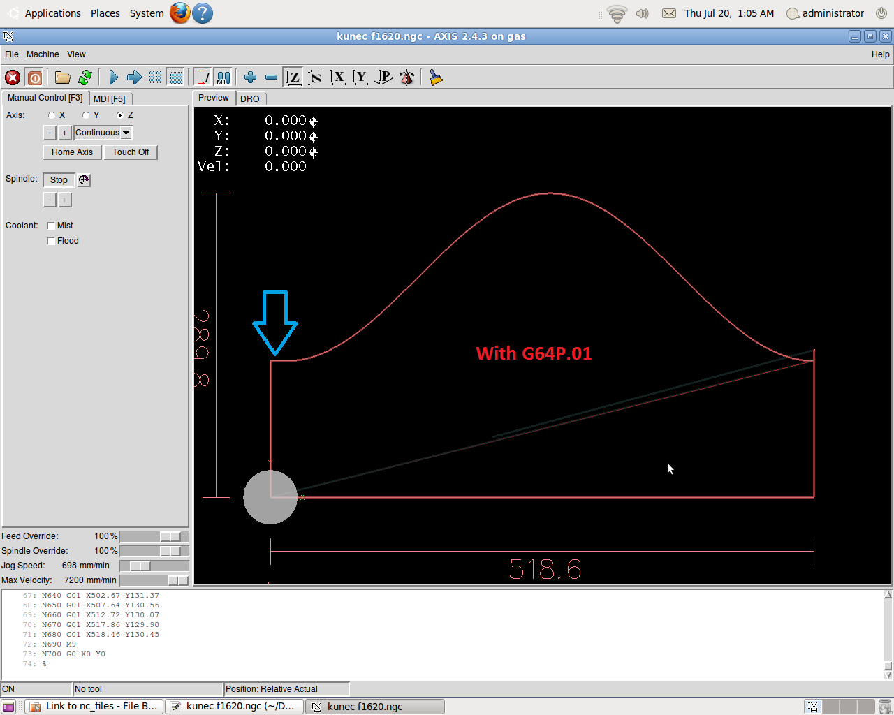

Thanks for the fast reverse !!!! On the first picture I have not used G64, and you see the program round the corners. But it does well with the arc. On the second picture i use G64 аnd does not round the edges, but when it reaches the arc the machine starts and stops for a few seconds and so to the end of the arc. I apply the G-code.

You are using a quite ancient version of linuxCNC (2.4.3), I would update to the current = 2.7.10

That isn't completely unexpected, especially on a machine with lower acceleration settings, because your curves are actually a series of line segments (lots of little corners). You may have experiment some to fine tune your G64 P setting to find the most optimal compromise between rounding the corners you want to keep and smoothing the corners of the line segments in your curve.
Try setting it to G64P0.05 and G64P0.1 to see if the corners are square enough for your taist and if the curve movement is smooth enough. Or you could change the G64P setting in the file. There is no rule that says you can't change it while the file is running, setting a large P for areas where you need smoothing and a small P where you need the path followed precisely.
Edit:
I didn't see the Linuxcnc version you were running. Good catch Peter Changing to 2.7 with the new trajectory planner should greatly reduce the slowdowns while running your curve, even with a smaller G64P setting.

On 2.7.10 we met the same problem ;/
