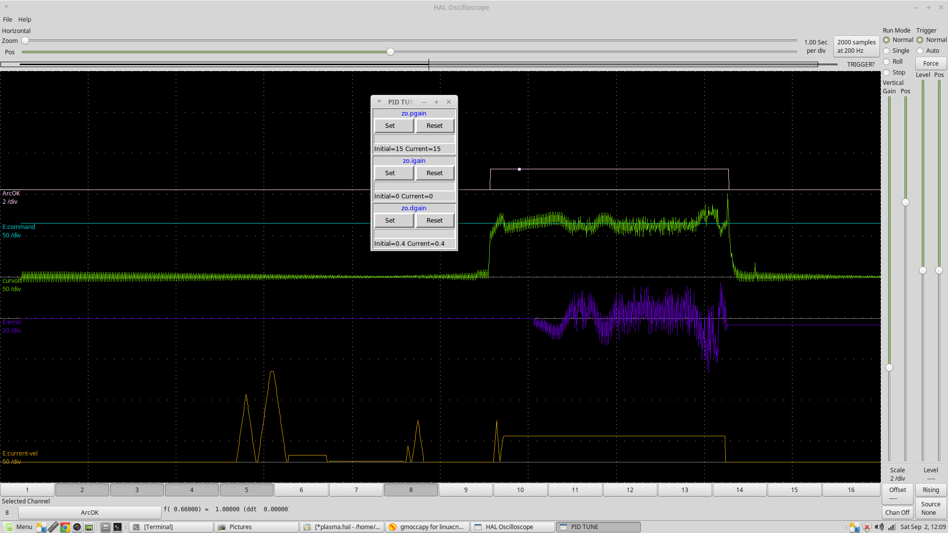

Replied by rodw on topic THCAD-10 + hypertherm 45 (nonXP)
Just hook it up and see what happens. Its not an electrical signal so you are not going to blow something up. Use halscope to see how clean the divided voltage signal is in a live cut
If you get a noisy signal something like this rather than the clean plots published earlier on this thread, then you have a noise issue.
If noisy try disconnecting the drain wire from the THCAD and see if it improves so the cable screen is only connected at the plasma end.
You can see that the noise shows up on 0 volts so just connecting things up and powering up your plasma cutter without cutting is probably all you need to do initially to find out if it is likely to be a problem.
