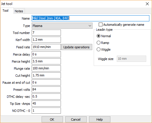

You may be overthinking it. There is probably only minor modifications required to your existing postprocessor so I'd investigate that as my preferred option.
In sheetcam, the kerf width is defined for each given material and plate thickness (eg. for 2mm Mild Steel) so it knows what offset to apply. Basically all of the key cutting parameters are contained within the material definition (pierce height, cut height, pierce delay etc..)
Sheetcam also supports plasma drilling operations.

But you see this is reversed from a big boy industrial control and nesting software. At least from my experience.
The CAM programmer should only be concerned with the selected amps and standard feed rate for that material type, grade and thickness. Each has a code to send to the control for the offsets.
The control uses that code to search its database for the required parameters. If the parameters are off the operator can adjust them for that run (material variences etc) and even future runs in the control if just wrong. Also keeping in mind as consumables age things change...
Neither CAM programmer nor operator are concerned with the pierce height, gas flows etc. The control manufacture has that all in the control and optimized the the material and thickness.
I realize this is a different sandbox, and most likely I will learn it can be done both ways. Just pointing out how in my experience it has been done before the latest industrial controllers.
A point worth making is.... With all the true hole technology and beveled cuts etc... The control/torch manufactures are requiring you to also use their CAM nesting software... Only way they can control things enough to get desired results. Which I guess is the same as what we are trying to do.

Very similar I think. Here is a sheetcam tool definition for 2mm mild steel.
Pressure and amps are missing but I've disabled the RS485 option in my post processor which is probably why they are not showing.
So you apply this toolset to your job (nest) and it knows everything about how to cut 2mm mild steel. You generate the gcode with a mouse click and the gcode sets all the parameters. As you say the operator should know nothing.
I don't think it would be hard to maintain a database of these settings and have Linuxcnc retrieve the correct record and set it up the same way. It would be the python language processing this and it makes file handling very trivial. In fact, it looks like there might even be a python database library so you could maintain indexed data files and use a separate python program to manage your database.
So how do you select the material you are cutting? on the console or in gcode?

OK finally got my laptop with touch screen to have a dual boot.
Built a 4.9.4 RT Mint 18.1 32bit. (tried others but nothing but problems - almost killed me to put on 32 bit though LOL)
Built dgarr/external_offsets LinuxCNC dev branch.
Trying to learn what HAL is all about.
One thing I noticed is the Plasma gmoccapy seems much more broken then the base package, can't seem to home, move around, etc. etc. I found a really good man/html on it, but for the life of me can't find it again. LOL information overload.
EDIT right G search found it for me again. wiki.linuxcnc.org/cgi-bin/wiki.pl?Gmoccapy_Plasma
Is that yours? Or you have one you have fixed up?
As to the material size question. That is being done in the nesting software, currently only passed to controller via comments, as it only has a roller at this point.
